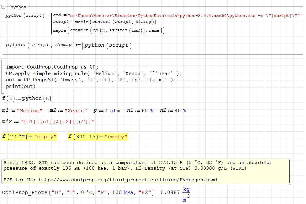

How can I get properties of mixtures e.g
CoolProp_Props("Dmass","T",273+100,"P",101.3*10^3,"Helium[0.5]&Xenon[0.5]"
ref: http://www.coolprop.org/fluid_properties/Mixtures.html
This can't be done directly in the current version of the plugin. It is not clear how to call the apply_simple_mixing_rule() function from the library, it can't be imported as it is not in the export table.
Click to enlarge
Click to enlarge
maple-python-coolprop.sm (6.61 KiB) downloaded 1301 time(s).
maple-python-coolprop.pdf (19.18 KiB) downloaded 764 time(s).
Click to enlarge
maple-python-coolprop-2.sm (5.08 KiB) downloaded 1275 time(s).

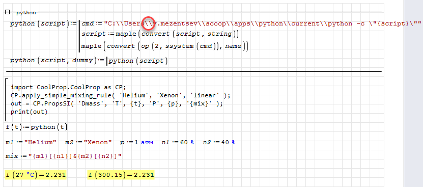

#71 Posted: 7/31/2023 3:45:32 AM
1,533 likes in 1,850 posts.
You should use a double slash for the full path.
I event tried environmental variables under Win10 but didn't work
In this case, you need to check whether python is available from the command line. If not, it means that the paths are specified incorrectly.

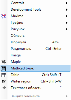

Can you tell me what is this block you used after python sub-section [i.e with the square bracket & holding script conetnts]
Additionally Razonar sample here is also very intuitive while calculating mixing values
https://en.smath.com/forum/yaf_postsm82120_Understanding-Redlich-Kwong-equation-of-state.aspx#post82120
#73 Posted: 8/3/2023 3:06:16 AM
uni, thanks a lot
Mathcad Block from the Mathcad Toolbox plugin and just Text inside it for the script.

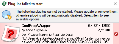

It seems that multiple instances of SMath can't use the plugin at the same time.
How to reproduce:
1. Open SMath and access any Coolprop function
2. Open another SMath instance: You get an error message

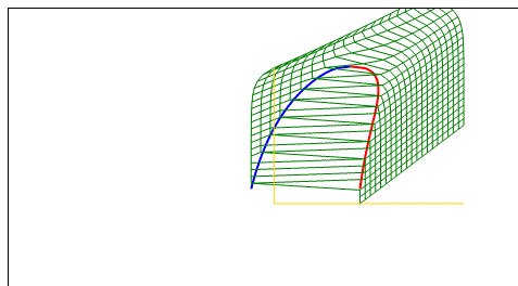

#79 Posted: 12/19/2025 1:10:36 AM
1,081 likes in 1,754 posts.
Phase diagrams with CoolProps. ...
Now can show other thermo properties, and get animations.
PhaseDiagram.sm (46.88 KiB) downloaded 266 time(s).
Animating volume of water and enthalpy of O2.
Вячеслав Мезенцев 12/19/2025 6:44:49 PM
