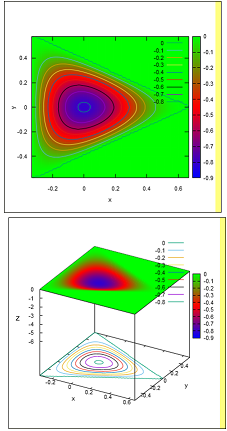

#15 Posted: 1/3/2021 1:23:53 PM
Vibrations of a triangular membrane(Maxima)
TriangularMembrane Maxima.sm (279.28 KiB) downloaded 1450 time(s).
Alvaro 1/4/2021 12:30:00 PM
