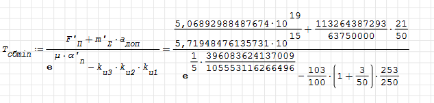

Hello. Tell me, please, is it possible to see the set numerical values when calculating formulas in the program? I mean, instead
of
a = 5, b = 6,
a + b = 11
see a = 5, b = 6,
a + b = 5 + 6 = 11

In the simplest case, this option would be suitable, but if the formula is a little more complicated, then we get a pile of fractions and numbers

I don't see the result in the attached screenshots of how it works. A jumble of formulas where there is no clear answer.
