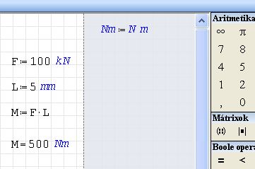

#8 Posted: 3/12/2013 3:25:04 PM
kadpeter
kadpeter
0 likes in 10 posts.
I think, this way is better:
Nm:=N*m (I write this most times to the nonvisible area)
F:=100 kN
L:=5 mm
M:=F*L
M=500 Nm
Best regard
Peter

I typed it in the way kadpeter's example shows, but I'm still getting Joules as the resulting unit of measure...
Image:
http://snag.gy/n4ZRf.jpg
Can anyone walk me through the steps for achieving the results in N*m? Isn't a major issue, but it would be nice to know how to do this.
Because you didn't enter the apostroph. In Kadpeter's example you have to type 'Nm:=N*m The apostroph will disappear and Nm become blue

@mkraska: Thanks for pointing out that there is a portable version of SMath. Great addition to my toolbox.
@brotjob: That solved my problem, and my custom units are working more-or-less as I would like them.
