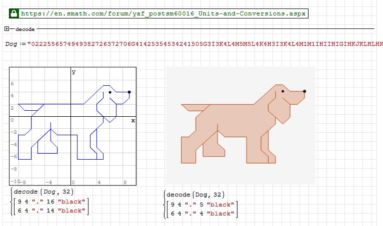

Yes, thank you, it expands the space, but it's not very intuitive. Maybe we can sacrifice the numbers and leave only the letters? Small letters are positive coordinates, and large ones are negative. Zero can be left in the middle. Maybe we can change the sequence like that?
P.S. Although no, you can leave it as is ( there is a coding function ). This is not very intuitive for manual coding, but for automatic coding it is normal.
You can name the function with one word - codec. Processing depending on the argument type. Also, when encoding, you can automatically determine the size of the area and specify the second parameter with the first two digits in the text. When decoding, it will be clear which alphabet to use.
I want to add examples of drawing by points to the X-Y Plot plugin, to the context menu, but the standard usage is too long. So I came up with the idea of ​​making coding for polylines as text.
If I find a universal convenient algorithm, I will include such text lines as an alternative option for specifying polylines.

I think the polygon drawing using a 2 column matrix (as it is part of the add element menu) is easy to understand and gives the basic idea how to do it. Perhaps one of the lines could get a third point such that the user sees that the method is not restricted to single segments. Also, the restriction to integer coordinates is quite a heavy limit. There are not many options to draw a paper plane this way. Sort of vector-based pixel art or pixel-based vector art.
Yet I see that the string encoding allows to much easier insert points, while adding points to manually edited matrices is a pain in the ass as long as SMath doesn't have basic row/column insert/delete function. For 1D array objects it is ok but not for matrices.

I need simple examples to explain the drawing capabilities that the plugin supports. As it turns out, people don't understand that they can draw not only with polylines, but also with sets of polylines. The same with shapes. You can draw sets of shapes as a single object (single trace).
If I insert a bunch of nested matrices, then at first there will be no sense in it. Simple examples are needed to gradually introduce the use of sets of nested matrices of various kinds.
Yes, this encoding is primitive, but after playing with it, it seems to me that they will want more.
I read some foreign forums where they try to draw shapes and not so many people understand how to do it correctly. Instead of combining and drawing in groups, they draw one piece at a time.
Perhaps this will be interesting to children.

Yes, you explained it to me with a couple of examples a few days ago, and I still don't use it. Maybe you could use base 52, with A,B,C,... = 0,1,2,... and a,b,c,... = -1,-2,-3,... Also separate with optional spaces and truncate the coordinates to facilitate the encoding of simple drawings that you have that are not integer coordinates, among some scale function than can be applied too. Visually it could look better: lowercase coords are negative and uppercase are positive, and the lexicographical order gives an idea of the length.

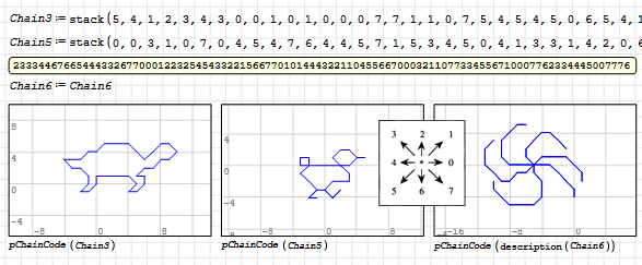

Hi Viacheslav. Another code: Freeman Chain Code of Eight Directions.
Chain Code.sm (17.74 KiB) downloaded 1775 time(s).
