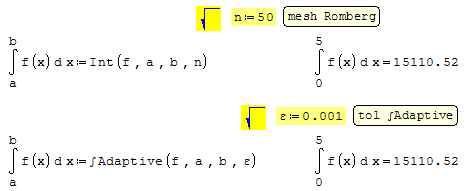

#25 Posted: 12/27/2021 5:19:04 PM
#26 Posted: 12/27/2021 5:41:45 PM
