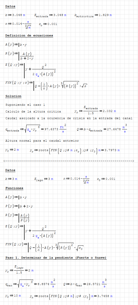

I need to pass these codes that are in Mathcad Prime to Smath, does anyone know how I can do it?
#2 Posted: 12/20/2021 3:19:50 PM
1,555 likes in 1,867 posts.
There is currently no converter from .mcdx format to .sm. And there is no one to do it, although it is possible.

But the programming is the same in Smath? I mean, for example the FYN or root function still works?
#7 Posted: 12/20/2021 4:08:32 PM
598 likes in 1,380 posts.
Not same, but very similar.

#8 Posted: 12/21/2021 12:05:20 PM
But the programming is the same in Smath ?
I mean, for example the FYN or root function still works ?
Smath has many solvers. FYN from implicit roots(,,,).
roots will solve on the canvas [MACH number]
calculo Direct Code.sm (20.59 KiB) downloaded 1111 time(s).

Maybe off topic between overlord and Jean Giraud's conversation, but what's the difference between a function definition with line() and a definition with line() removed? Will there be a difference on how SMath calculates it?
Cheers.
#15 Posted: 12/22/2021 9:01:39 AM
In short line | is a descending dependent collection.
Welcome to Smath Community ... Jean.
chito.sm (51.93 KiB) downloaded 1068 time(s).
...but what's the difference between a function definition with line() and a definition with line() removed? Will there be a difference on how SMath calculates it?
There will be a difference, a huge one actually.
When a variable is defined before function,
and that variable is used inside the function,
if line is used, variable redefine shall effect result.
if not used, variable redefine won't effect the result of function.
Which mostly we don't want not effecting, so using line() is better.
I mostly define function variables with unique naming. (# after variable for example)
So common used variable names won't effect function results.
This is my habit and I think it is a useful one.
This naming doesn't crowd pages or confuses people.
It is minimizing calculation errors caused by author.
f(x#;y#):=x#^2+2*y#

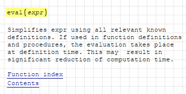

Is there a reason why Dy is within in eval()? I tried removing it in the function and the result looks the same.
I think this is a very important point that I need to keep in mind. Using unique names in functions is also a great suggestion. Thank you overlord.
Cheers.
#18 Posted: 12/23/2021 11:45:18 AM
Thank you for the very warm welcome, Jean.
Two typos in your 'chito' document: Manilla, Kota Kinabalu in Sabah.
You are right, no need to Dy:=eval(,) is so fast.
eval(,) applies to parse result as a numeric entity.
It breaks the chain calculation. Per application experimental.
The rule eval(,) is crucifying ... watch the demo attached.
from 65 s down to 0.015 s !!!
Take care ... Jean
Maths eval(,) TEST.sm (19.27 KiB) downloaded 1090 time(s).
In simple words, the kernel is a vector of calculated from what to calculate.
In this example, the last that will be calculated is eval([R G B])
It gains 1 min [3/4].
Cheers ... Jean.
Pattern Etoile Magic [Short].sm (81.1 KiB) downloaded 905 time(s).
#20 Posted: 12/23/2021 9:13:04 PM
eval() makes computations faster most of time.
Very minor times, may have no effect or slows the calculation.
It would be wise to choose where and when to use it.
