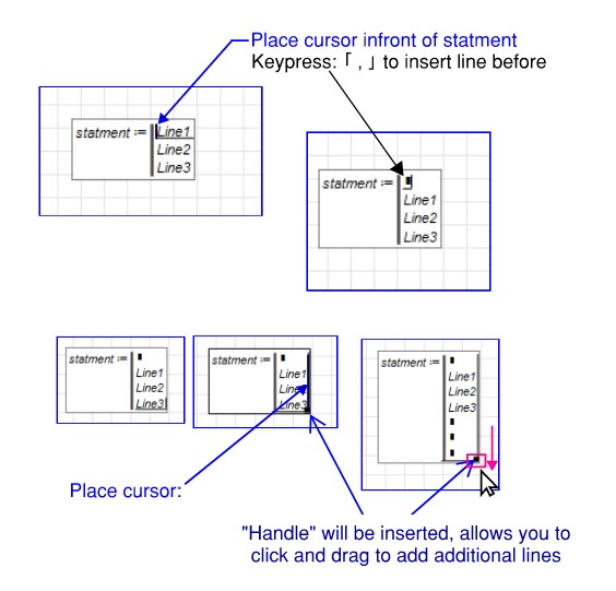

#2 Posted: 8/8/2022 4:26:44 AM
Just use the argument divider (comma or semicolon, dependent on the settings) while the cursor is at the appropriate position (line beginning or ending).
Joe Cahill 8/8/2022 12:22:00 PM
#3 Posted: 8/8/2022 11:56:02 AM
WroteJust use the argument divider (comma or semicolon, dependent on the settings) while the cursor is at the appropriate position (line beginning or ending).
Below is a picture with regards to MarB's instructions. In addition, there is the ability to click'n-drag the statement to increase the number of line items:

#4 Posted: 8/8/2022 12:21:15 PM
It worked, thank you all.

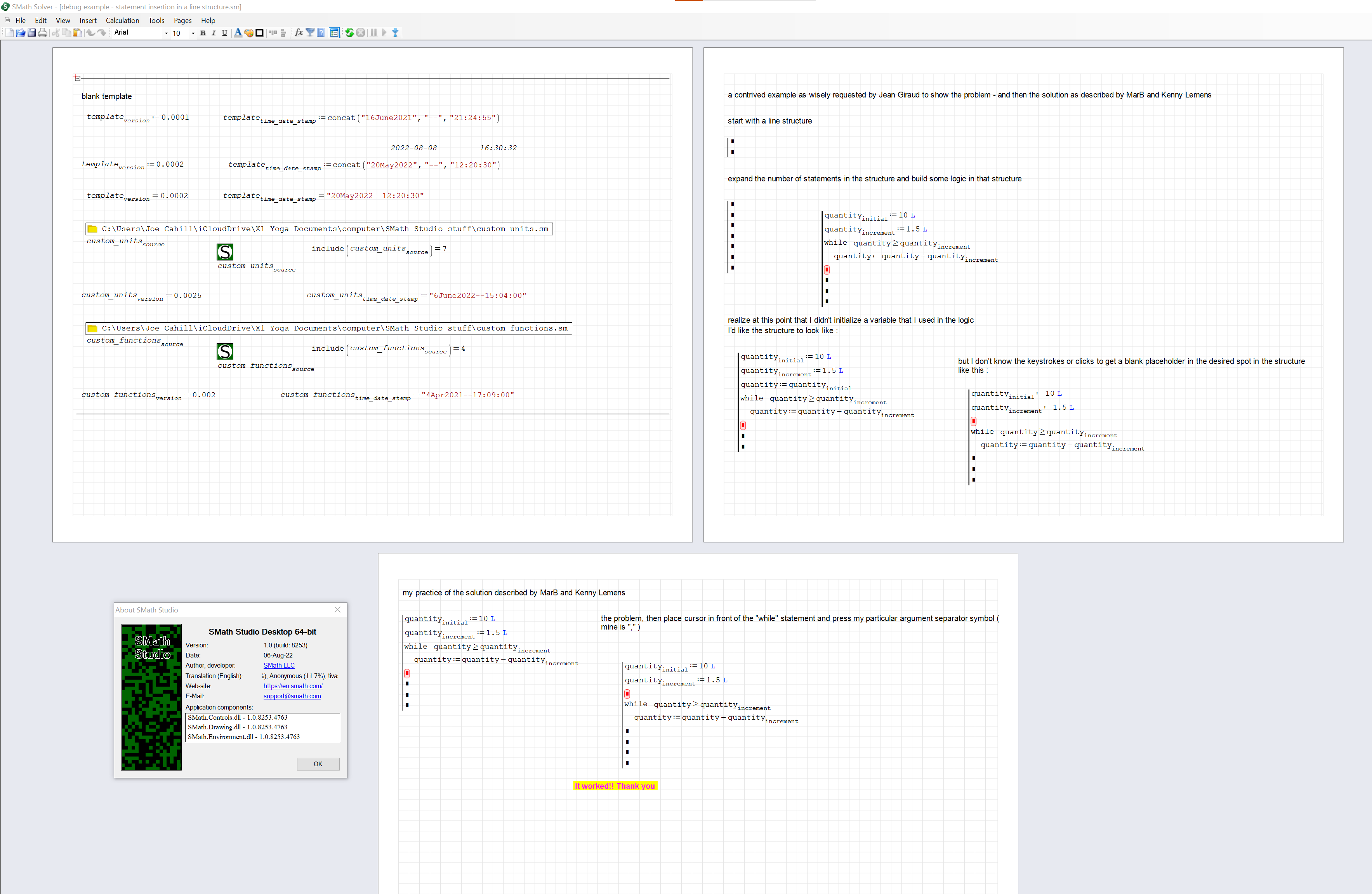

#6 Posted: 8/8/2022 6:39:11 PM
Hmmm, interesting.
Here's a screen snap of it open with the version of SMath Studio shown also and a pdf ->
debug example - statement insertion in a line structure.pdf (114.49 KiB) downloaded 724 time(s).
