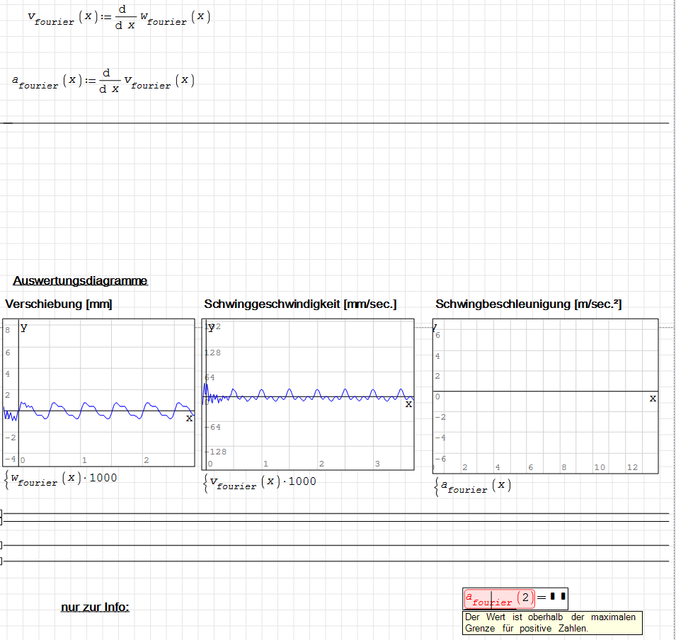

In some case there ist no Result in v(fourier) and a(fourier) diagram but this message:
need some Help please.

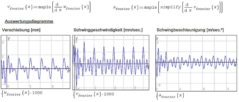

the script works in Version build:7030 and doesnt works in the latest build 7610. see the different screenshots here.
The Smath-script is attached.... Maybe there ist a lot for optimising...
I´m very thankfull for further tips..

Check and cross check your formulas and how you defined the equations (e.g. "[" for a matrix). At the moment, if I define x:0,0.1...1, the result for V.fourier(x) says that the "result is above the max allowed positive number"
In addition, W.fourier cannot be calculated, but the graph is visible
I guess not. Your worksheet seems to have all ok, and because of that I try to just take the derivative for a "simple" univariate function evaluating symbolically w.fourier, and copy and paste the result. The error in the derivative remains. So, the issue it's related with the numeric procedure in the SMath derivative, but not with your work and you haven't too much to optimize in your code. As workaround you can use your own numeric derivative.
w.fourier.sm (30.76 KiB) downloaded 1450 time(s).

1. I toke Alvaro Monster Big function
2. freaked a bit and discretized a portion,
3. proceeded B39 for continuous construction sanity check,
4. cinterp(X,Y,x) as it is continuous up to 2nd order derivative,
5. applied the infinitesimal derivative ... just perfect.
Fourier Budapest39 MonsterBig.sm (65.6 KiB) downloaded 1517 time(s).

Well, if that's true, you only need to simplify two univariate functions, the speed v and the acceleration a. For v maple() it's enough, for a needs an explicit simplify command.
LF_Aufschaukeln_4_Pers_Personenanregung_Fluchttreppe_allg__optional_getilgt.sm (408.3 KiB) downloaded 1565 time(s).
