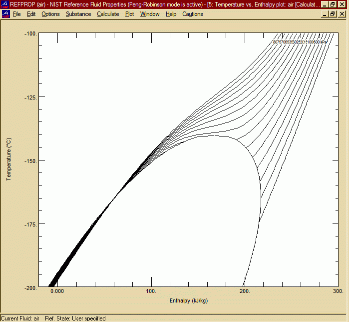

#22 Posted: 5/29/2016 2:38:24 AM
There are not "not yet implementing" or bug in CoolProp. If can't work in this region is because is very difficult to solve the inversion: For each enthalpy there are two valid temperatures in the phase line. Which make unstables (when not imposible) some algorithms. For this case the system can't be determined with the usual two intensive or extensive properties states, and need 3 or, inside the region, one intensive an the quality. See the attached diagram.
Or here, the diagrams for PR in mathcad: https://www.ptcusercommunity.com/message/424574#424574

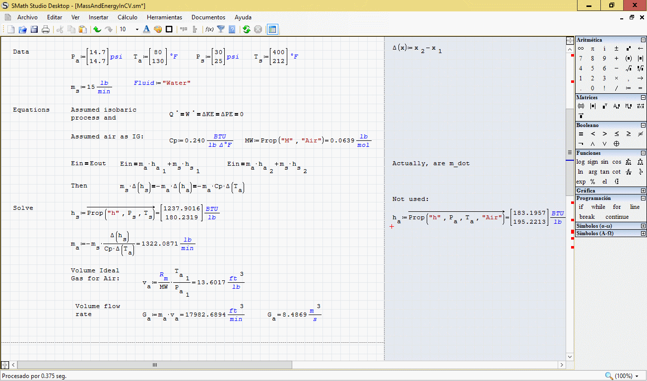

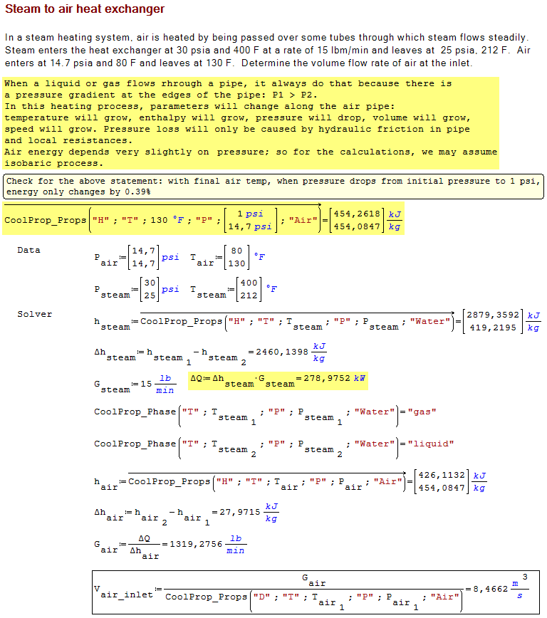

#23 Posted: 5/29/2016 3:00:15 AM
Mike Kaganski
Mike Kaganski
184 likes in 434 posts.
MassAndEnergyInCV_Mike.sm (20.83 KiB) downloaded 1449 time(s).
Edit: I see that the air flows outside the tubes; however, the said holds true: the pressure drop across the starting and ending points cause air flow; this pressure drop may be ignored for the task. The losses that are ignored here, constitute much higher indeterminacy.
С уважением, Михаил Каганский

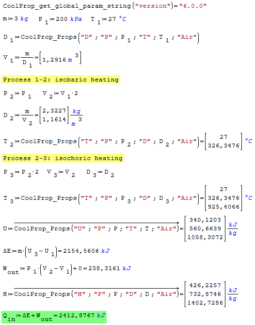

#24 Posted: 5/29/2016 4:44:48 AM
Yes, thanks, that's correct. Can be obtained also with mixing models: IG for air, steam props for water.
#25 Posted: 5/29/2016 4:57:09 AM
Mike Kaganski
Mike Kaganski
Edit: I'm sorry, uploaded some utter garbage. Updated file.
Air in piston-cylinder with stops.sm (16.68 KiB) downloaded 1510 time(s).

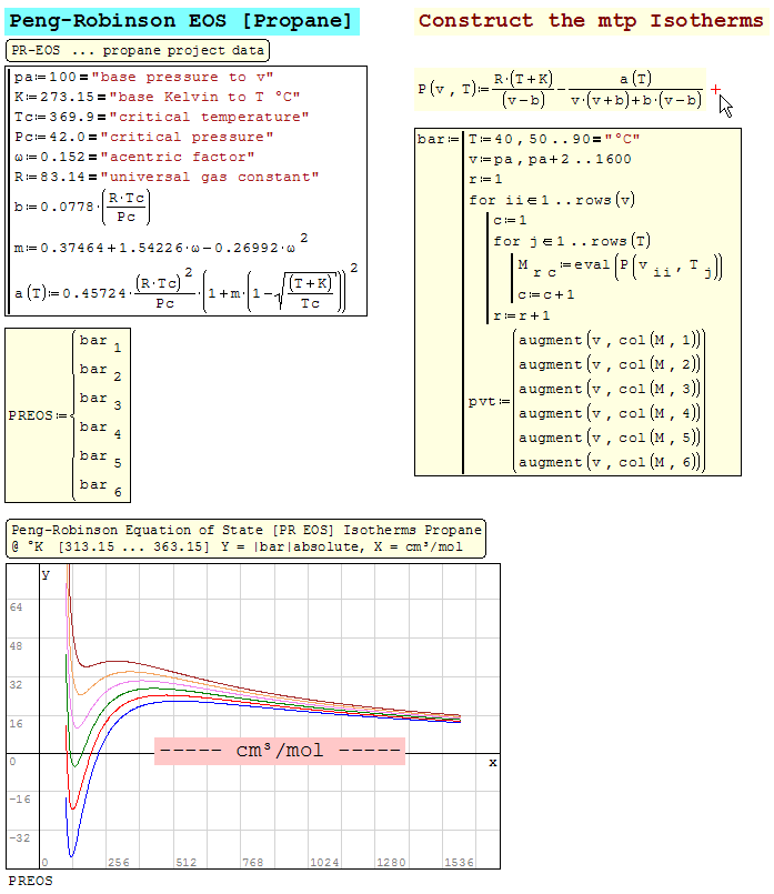

PR EOS.sm (44.14 KiB) downloaded 1451 time(s).

PR_work_Mike.sm (41 KiB) downloaded 1457 time(s).
Please notice that you had some errors, particularily in calculation of L.

#28 Posted: 5/30/2016 6:11:01 AM
Thanks Mike. I go to check. In my version (0.98 5935) there are some "Sintaxis incorrecta" errors from your attach.
#29 Posted: 5/30/2016 6:16:04 AM

Oh, I suppose these are assignments of variables in vectors:
http://en.smath.info/forum/yaf_postst7476_SMath-Studio-0-98-5953--19-April-2016.aspx

#30 Posted: 5/30/2016 11:56:58 AM
Too much for a monday morning, but most interesting the global collection.
Sure L ia a problem: denominator is complex. That kind of gigantic project
must be first constructed modular and sanity checked to extremas.
Why zillions of gyzmas #####... If they do nothing, why should they do ?
PR_comments.sm (25.86 KiB) downloaded 1472 time(s).

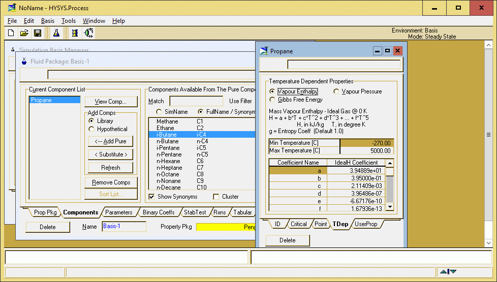

#32 Posted: 5/30/2016 7:22:33 PM
PR_work_Mike2.sm (48.83 KiB) downloaded 1548 time(s).
Take into account ref point's h and s non-zero values.
+Some refactoring
This is meant to be some framework.
To test, the specific reference to Peng-Robertson formulation used is required, because there are quite a number of those in literature.
Hi Mike. For this is put images from RefProp about the ref states. Hysys use another method, and have H(T), gibss free energy and vapor pressure constants which uses in conjuntion with the PR EOS.
Attached, a table with some other values for critical values and Cp of ideal gas.
Righ now have not to much time to analyze your file (and probably need to install other version, because give me errors).PR.zip (35.51 KiB) downloaded 502 time(s).

#35 Posted: 5/30/2016 11:29:16 PM
Some notes: what in the literature is alpha^2, in my ws is alpha. Phi isn't the fugacity, which is evaluated as f=P*exp(L). Is the conclusion of take the phrase "minimun fugacity provide most stable z", i.e. the manipulation for obtain the simplest expression which minimize f (hope errorless). Remember that in the mixture phase region, T,P are not independent variables, this is, with T,P only can't determine the thermodymamic state. You must to provide another information, like other state variable or the quality (x). For this reason is why I output only one z: which minimize the fugacity. If for any state you output two z I guess that is useless, that´s only for mixture phases region and in that case can´t use T and P, must to use (in the practice) x.
In my mathcad ws (not implemented yet in smath) I output also for vf, hf, uf, sf, vg, ... etc (f liquid phase, g vapor, in german). This is equivalent to f for x=0, g for x=1. I use Lee-Kesler eq for get the aproximate point in the change phase line, and root for the value, but I'm not convinced of this.
