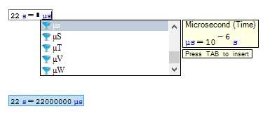

By default, 「's」 is the base unit in SMath (and thus, the default unit of time); any calculation in terms of time will report in seconds. If you want to review your answer in microseconds, you can insert microseconds in the placeholder at the right of your equation to override the default units.
Clicking on your equation, you should notice a ▮ appear, just type the unit 「'μs」 and you will see your desired result:
