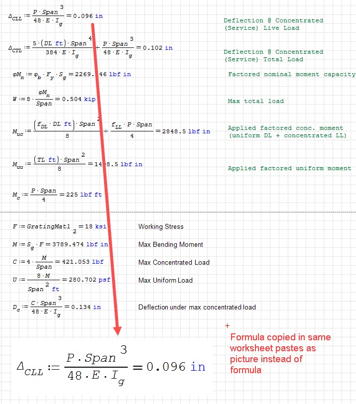

I'm having a problem now when I try to copy and paste formulas between worksheets where SMath Solver pastes a picture of the formula into the new worksheet instead of the formula itself. It's intermittent as I can paste a picture of the formula, and then after a few more tries, correctly paste the formula itself. Anyone else having that problem? This slows down creation of new calcs tremendously if I can't copy and paste sections of formulas and common text from other worksheets already completed (like reinventing the wheel each time...). Any help is appreciated!

Now, it's happening even in the same worksheet. See screenshot below demonstrating what it's doing. The preliminary calc file is also attached this time, since it's happening in the same file, which there was no point attaching earlier since it was happening intermittently between files. Bar Grating Calc.sm (266.64 KiB) downloaded 1473 time(s).

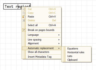

I never saw that behavior. The only SMath option that could be related to the problem, and that I know of, is the one shown in the image.
Perhaps changing some of those options will solve the problem.

Alvaro: what is that "Automatic replacement" option that you showed on the text region context menu? I didn't even know that was there, and when I search for it, I just see it listed as an item in the recent version history, but no explanation of what it does.

Hi. Yes, it is a new feature. Disabling it prevents clipboard content from being pasted into a text region like math. I have it disabled, but I think the default option is to have it enabled.
I have no idea if those options could be the cause of your problem, but hey, in the end they are options about the behavior of the clipboard in SMath.
