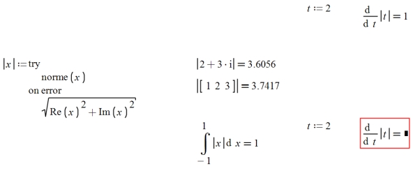

#3 Posted: 9/27/2020 2:10:21 PM
For only numerical procedures it seems that you can redefine abs(x) in this way:
Notice that this don't works for derivatives. It could be a good idea typesetting norme(x) as ||x|| (double bar).
sergio 9/27/2020 2:30:00 PM

#5 Posted: 9/28/2020 9:19:38 AM
makes the vector magnitude look like |x|
ArcLength.sm (49.46 KiB) downloaded 1268 time(s).
