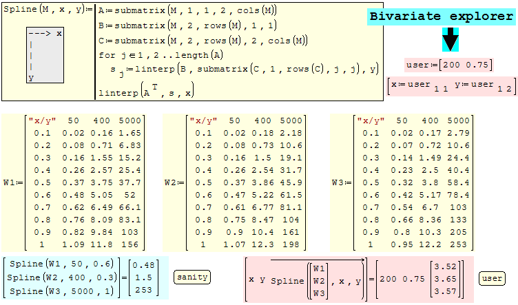

Spline/Interpolate Matrix
Spline/Interpolate Matrix - Spline/Interpolate Matrix - Messages
#1 Posted: 11/22/2017 10:45:06 PM
Spline Matrix Tutorial METRIC Domain.sm (88.16 KiB) downloaded 1331 time(s).
frapuano 11/23/2017 3:48:00 AM, sergio 11/23/2017 8:36:00 AM
#2 Posted: 11/23/2017 8:39:27 AM
The bivariate "linterp" is reputed behaves like Quadratic
Spline Matrix Tutorial METRIC Domain EXPLORER.sm (14.73 KiB) downloaded 1265 time(s).
