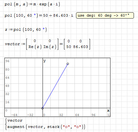

#2 Posted: 5/27/2022 1:57:54 PM
1,555 likes in 1,867 posts.
You can use this method
#3 Posted: 5/27/2022 8:25:23 PM
Joseph Lo
Joseph Lo
0 likes in 4 posts.
Thanks uni for that. I tried it and it seems to work - but is it possible that i don't key in the "degree" sign and still get the same result? i.e. the polar form of 100/_60deg = 50 + j86.6.

#4 Posted: 5/28/2022 2:24:39 AM
I tried it and it seems to work - but is it possible that i don't key in the "degree" sign and still get the same result? i.e. the polar form of 100/_60deg = 50 j86.6.

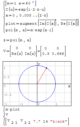

#5 Posted: 5/28/2022 1:24:22 PM
Plot the circle as well.
Thanks! that works well.

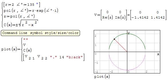

#8 Posted: 5/29/2022 8:36:55 AM
Interesting thanks for that. I will experiment with that.
You can have it Class Room style.
Cheers from Up There to Down Under ... Jean.
