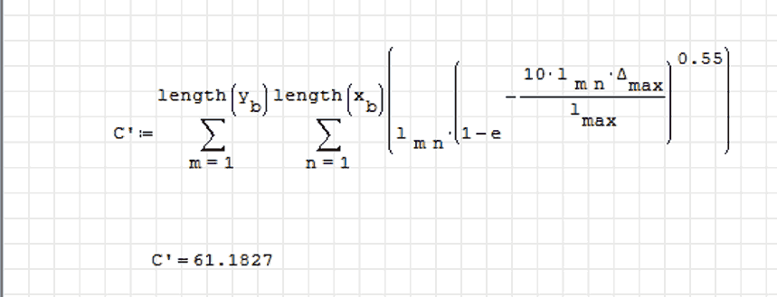

I'm trying to recreate a mathcad calculation in smath and I'm not sure how to make the evaluation "l" which is the resultant distance for each point.
Thanks in advance for any help.

#2 Posted: 7/26/2016 8:02:04 PM
Here you go. There might be another way to do this, but this was the first I thought of.

Thanks Ernesto.
@Jean
The next step is to use the C' equation to for each bolt resultant distance to center of group.
I think I've got the C' equation working but I'm sure there is a better way.

#5 Posted: 7/27/2016 12:17:10 PM
Wrote"Uncle Sam",
By inspetion, I kind of understand the C' formula,
just a matter to code Smath. Will be back tonight.
What is Δmax ?
Thanks for the help.
Δmax = Maximum deformation on the bolt farthest from the center of gravity.
Empirical set value = 0.34 in
#6 Posted: 7/27/2016 12:52:08 PM
you can use the same formula
