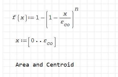

#1 Posted: 7/11/2023 2:40:19 AM
soomoon
soomoon
1 likes in 42 posts.
How to find area and centroid
question_20230711.sm (2.88 KiB) downloaded 1352 time(s).

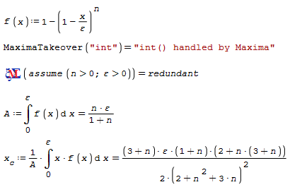

#2 Posted: 7/11/2023 4:59:38 AM
Ac.sm (6.17 KiB) downloaded 1304 time(s).

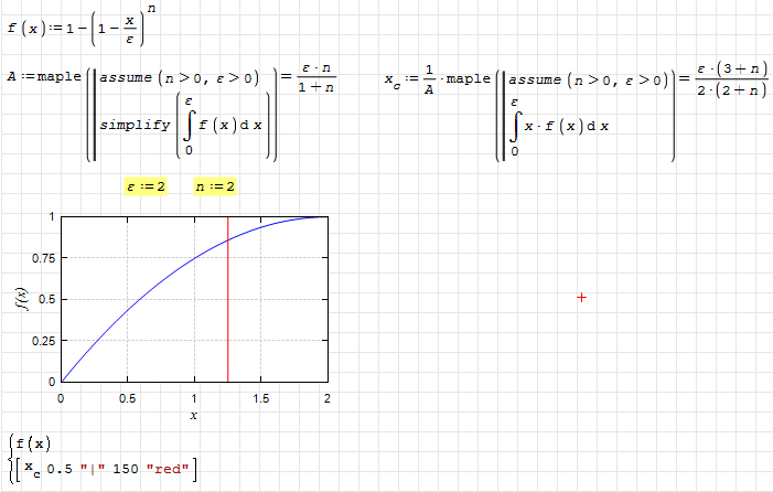

#4 Posted: 7/11/2023 8:47:36 AM
Make your function parametric f(x,e,n), plot some typical.
f(x,0.5,0.5) ... f(x,0.5,2) ... f(x,0.5,3)
Discretize the range(s) of interest.
... suite for: Area, Perimeter, Centroid
#5 Posted: 7/11/2023 9:17:41 AM
1,555 likes in 1,867 posts.
Ac (uni).sm (8.4 KiB) downloaded 1338 time(s).

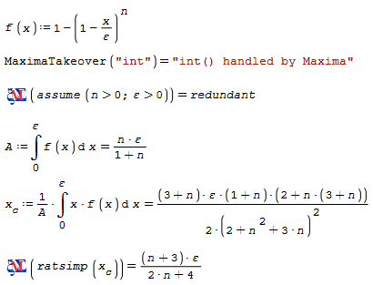

#6 Posted: 7/11/2023 9:40:34 AM
Maxima is a bit lazy with simplification...
Ac.sm (7.08 KiB) downloaded 1299 time(s).

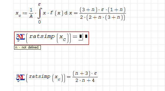

#7 Posted: 7/13/2023 2:39:23 AM
soomoon
soomoon
why can't i do right that?
what's the problem?
