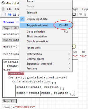

What does this refer to:
"Shortcut key added to Toggle Breakpoint context menu item"
Thanks!
#3 Posted: 8/20/2016 4:46:17 AM
2273 likes in 3737 posts.
Sure. Screenshot added above.
