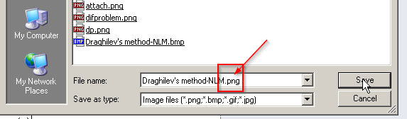

I have had the same experience as a new user of SMath Studio(Ver.95.4594) and I also attempted to save as a .JPG or .BMI file format but I am not able to open these image files with Word or MS Paint. Is there a specific method of saving other than changing the suffix from .sm to .jpg or .bmi? BTW, I also tried to copy/paste with special paste in word 2010 but still no luck. Any suggestions?
#6 Posted: 1/2/2013 5:18:18 AM
325 likes in 2052 posts.
Did you follow these steps?
1. Open an SMath file
2. Select "File|Save as..." from the main menu
3. In the "Save as type" select "Image files (*.png,*.bmp,*.gif,*.jpg)"
4. In the "File name" add one of the four above mentioned extension
See the picture please. I just add the extension ".png" to point out the file will be saved in PNG format
