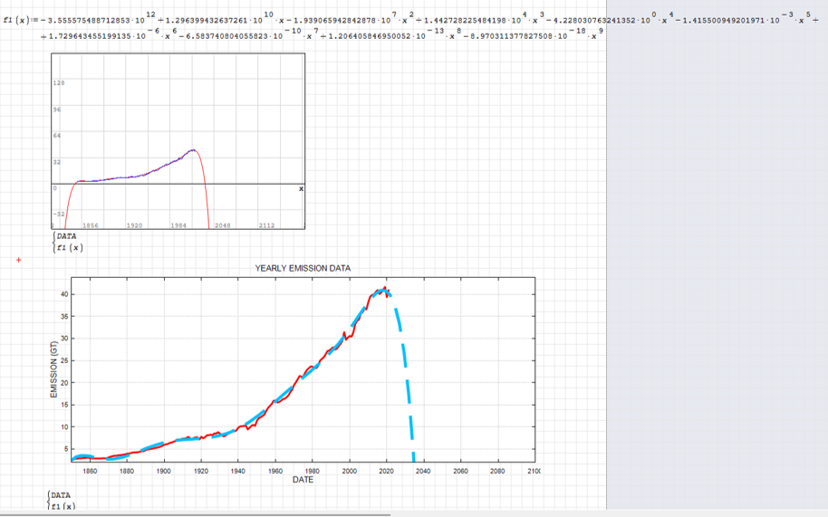

Hello
I believe that one of the best fits for the data supplied is in polynomial of degree 9,
with a correlation coefficient of 0.999254.
It seems to me that emissions cannot grow forever and that
they could remain at 2021 levels or even fall.
CLIMATE CHANGE WORKING_CBG_r4.sm (155.02 KiB) downloaded 1325 time(s).

WroteIt seems to me that emissions cannot grow forever and that
Indirectly, that's what HadCRUt4 proves from my last updated 2019.
The Global Warming [2010] 0.8 °C dropped to 0.75 °C [2019]
Taking a range of the last data will closely be Verhulst asymptotic.
