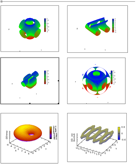

Two surfaces are taken from the site
http://xrt.wikidot.com/gallery:implicit
The calculation algorithm:
1.Find the line of intersection of the given surface with the plane Z=0
2.Through each point hold the plane x1 = C and find the line of intersection of that plane with a given surface.These lines represent a given surface.
Davide Carpi 1/30/2017 9:18:00 AM

#7 Posted: 1/31/2017 5:50:55 PM
The tube in the form of a line of intersection of the cylinder and the torus (See post 7)
http://en.smath.info/forum/yaf_postst2307_Method-A-B--Draghilev-and-animation-spatial-mechanisms.aspx
Time calculation, 9 min.
Villarceau 9.sm (39.38 KiB) downloaded 1214 time(s).
Davide Carpi 2/1/2017 5:58:00 AM

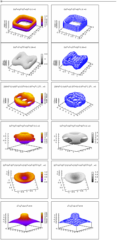

#14 Posted: 2/6/2018 5:06:49 AM
Nice examples!
Just some remarks for those who want to play around with Maxima Draw.
ImplicitMaxima_Kr.sm (492.51 KiB) downloaded 1317 time(s).
![2018-02-06 08_55_49-SMath Studio - [ImplicitMaxima.sm_].png](/en-US/files/Download/BoD4rH/2018-02-06-08_55_49-SMath-Studio---[ImplicitMaxima.sm_].png)
- Instead of Image region with Draw() command you can use Maxima Draw3D region with interactive zoom, rotation and resize and a settings dialog.
Insert-> Maxima-> Draw3D - The performance isn't overwhelming, as the image is recalculated for each interaction.
- The snippet "draw" provides help texts for the available draw commands and options.
- Follow the link in my signature to see how to configure SMath with Maxima.
