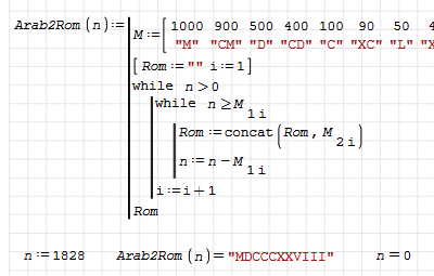

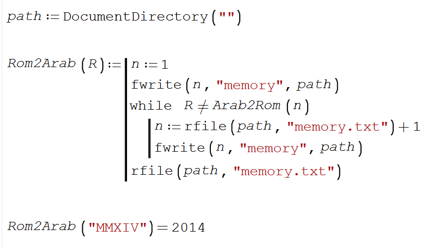

Why doesn't the cycle end?
See please the attachRome-Arab.sm (40.3 KiB) downloaded 1449 time(s).
#2 Posted: 10/19/2023 12:53:00 AM
Oscar Campo
Oscar Campo
135 likes in 309 posts.
Really it's a very strange bahavior (a bug ?), because the value of variable n is cleared when function returns from Arab2Rom()
So, a solution is to use functions fwrite() and rfile() to save the value of n on a file as a memory:
See the atachment with the solution: Rome-Arab SOLVED.sm (41.21 KiB) downloaded 1434 time(s).
best,
Oscar
Valery Ochkov 10/19/2023 1:08:00 AM
#3 Posted: 10/19/2023 1:30:20 AM
Hi. In Arab2Rom(n) you modify n.
That's not good practice. This is a workaround for such cases.
Valery Ochkov 10/19/2023 1:46:00 AM, Oscar Campo 10/19/2023 1:46:00 AM

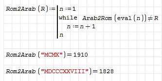

But this have an error too!
Rom2Arab.sm (293.29 KiB) downloaded 1426 time(s).

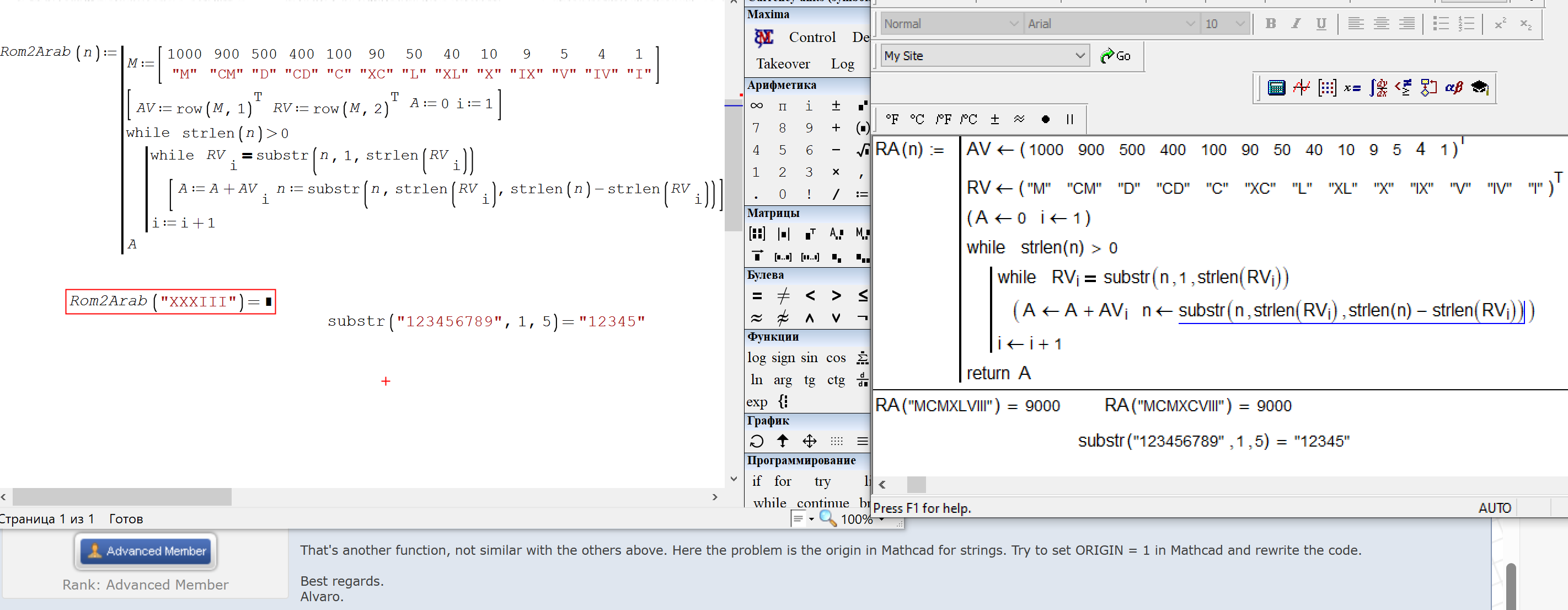

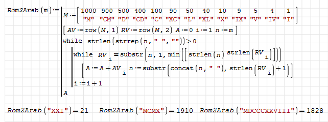

That's another function, not similar with the others above. Here the problem is the origin in Mathcad for strings. Try to set ORIGIN = 1 in Mathcad and rewrite the code.

This is one way.
Valery Ochkov 10/19/2023 2:49:00 AM

Thanks,
send please the sm-file!

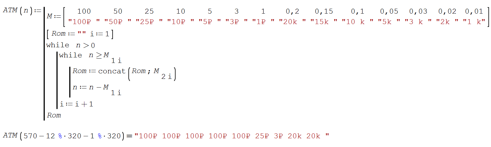

My salary in 1980
ATM-SU.sm (6.29 KiB) downloaded 1435 time(s).

If I remember correctly, 1988 a bottle of vodka (0.5l) was 3 rubles (if you got it at all, it was the time of prohibition - сухой закон). Therefore the 3-ruble-notes.
Valery Ochkov 10/23/2023 2:31:00 AM

2 рубля 87 копеек = 2.75 vodka + 0.12 bottle.
Three constants of soviet students 3.14, 2.87, 2.72
