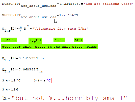

i have to questions at the moment:
-is it possible to write a overdot like for the volumetric flow rate?
-how could i write double subscripts?
e.g.:
Many thanks in advance!

#2 Posted: 7/19/2016 6:54:08 AM
Hello Topaz,
I have no answer to your first question - I don't know.
Maybe another user has a solution for that.
To your second question:
as far as I know (and use), you can only write one (1) subscript, but you can than add an index number with the "[" key.
in fact you define a vector.
see the attached fileFile not found.File not found.
kind regards,
csb

#3 Posted: 7/19/2016 9:43:58 AM
In maths works ang Engineering works, subscripts are confusing.
To me: completely useless, never use. Occasionaly, as short
description is usefull to evidence the RHS construction.
Further, Smath is very limited in the ASCII 'Alt+0key'. Probably
because of the so many languages it was designed to accomodate.
NONE of my Smath Engineering work sheet contains subscript.
Inst_Colebrook Pipe Data.sm (60.85 KiB) downloaded 1175 time(s).
Inst_Orifice Plate.sm (430.13 KiB) downloaded 1222 time(s).
