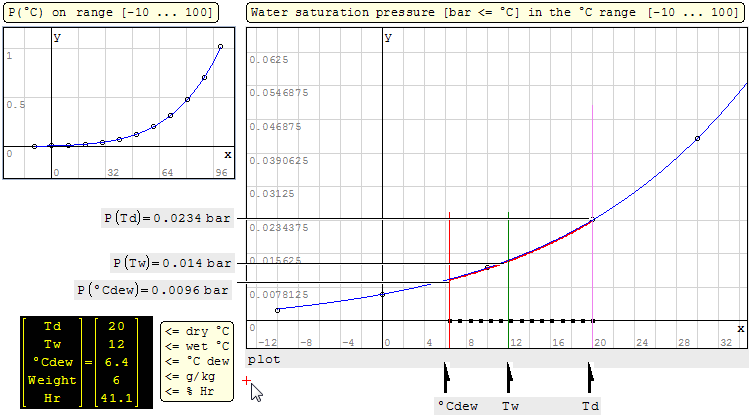

#1 Posted: 4/9/2018 9:49:03 PM
983 likes in 6866 posts.
... refreshed for publishing.
Inst_Psychrometry [Weather Station].sm (221 KiB) downloaded 91 time(s).
