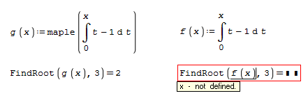

#5 Posted: 7/16/2023 10:06:23 PM
SMath solvers can't take an integral in the arguments, except al_nleqsolve.

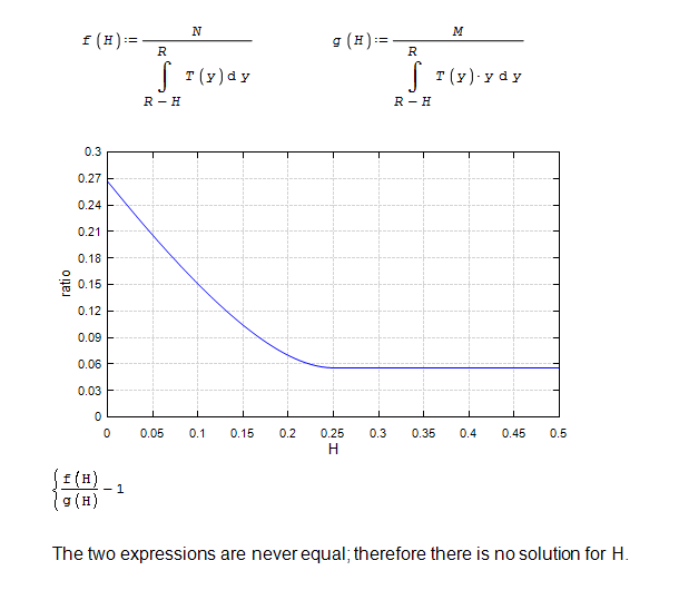

#6 Posted: 7/17/2023 4:37:53 AM
StvMath
StvMath
44 likes and 1 dislikes in 71 posts.
There are no roots!
mod: image link fixed; please use the forum attachment function (paperclip icon ) instead of external services
Worksheet4b.sm (18.29 KiB) downloaded 1286 time(s).
