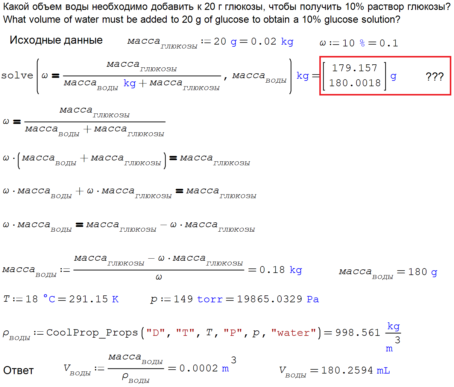

Why two solutions?
Why two solutions? - One chemistry problem - Messages
#1 Posted: 10/20/2023 4:53:00 PM
Valery Ochkov
Valery Ochkov
55 likes in 633 posts.
Glucose.sm (11 KiB) downloaded 76 time(s).

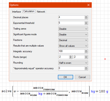

Solve is a numerical procedure. Like all numerical methods, it has the usual issues. Reducing the search interval increases accuracy, returning only one solution. Notice that in the picture the actual interval is from -2000 grams to +2000 grams.

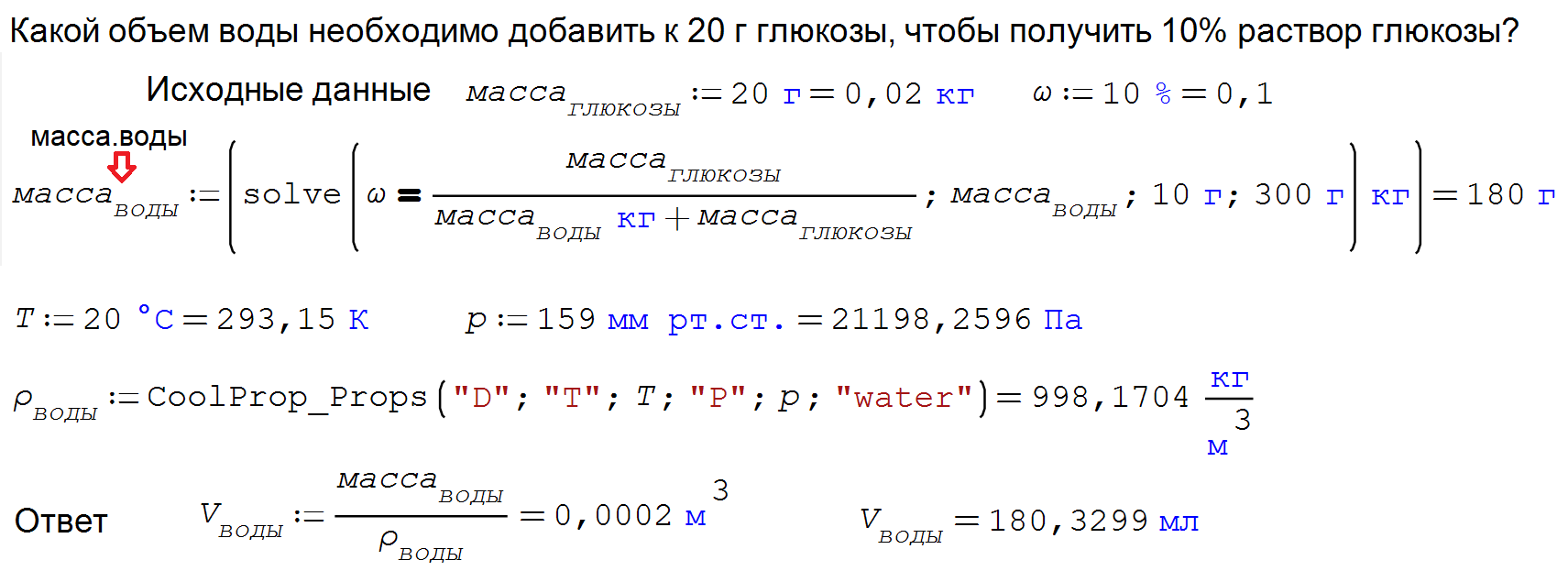

#3 Posted: 10/21/2023 2:25:18 AM
Valery Ochkov
Valery Ochkov
My solution
