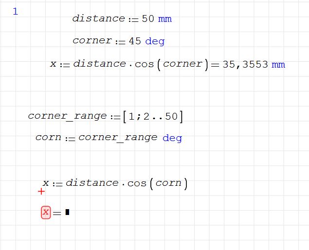

Dear
I have problem with rank along with unit.
Par example: x = 50mm * cos (30 deg) = 35,35mm
But when I use range corner = 0,1,2...50
x = 50mm * cos(corner) don' work!
I try with vector, but it don't work.....
Thanks

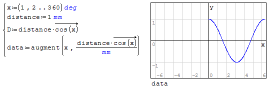

#2 Posted: 8/5/2021 4:33:03 AM
127 likes in 342 posts.
in fact, the solution has already been given to you.
cornerRange.sm (6.1 KiB) downloaded 1192 time(s).

#5 Posted: 8/20/2021 2:43:32 PM
Ruben Sidranski
Ruben Sidranski
17 likes in 465 posts.
Dear
Thanks
If you pay attention to the others solutions, you missed the VECTORIZE function
