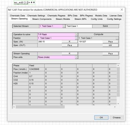

You must copy ppp.dll and prode.dll to the userefi folder and restart the program. After that you must point to some location when document opened.
I don't have this archive and this folder and I no longer remember what it is for. But now all functions are accessible.
When the program is running, you can see the list of loaded functions in the log file (mcadefi.log) in the folder with the plugin.
Procedure:
1. Calculate the entire worksheet, ctrl-F9
2. Select dep.ppp archive when first window appears, and click Open
3. When second popup window, the Prode archive, appears, it should show stream 2. Click OK.

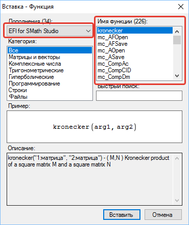

I added the ppp.dll to userefi folder, but only kronecker and Psi show in the function list for EFI. I have restarted the SMath program and also disabled EFI and then enabled it an still no mc_xxxx functions.
I created the test_ppp file so I know how to use it.

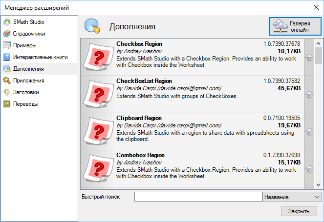

It is not recommended to use SMath Studio\plugins folder. For a standard installation of the program, all extensions are installed in the above path.
As I can see, you are using an old version of the plugin (1.0.6982.32016, Tuesday, February 12, 2019 5:47:12 PM).
The last version is: 1.0.7165.40625, 14-aug-2019 22:34:10
I don't know why you are using SMath Studio\plugins folder. Try to download last SMath Studio and install the plugin in standard way - using Extension manager in main menu.
After that - copy dlls to the plugin directory (not SMath Studio\plugins). Reopen the program and show me also \userefi\efi.txt file.

Here's the actual path where I found the plugins. C:\Users\Harvey\AppData\Roaming\SMath\extensions\plugins
Here's the path where my SMath program is currently installed: C:\Program Files (x86)\SMath Studio
As I recall, I only got to say where the program was to be installed, not the plugins.
Before I start the re-installation process, I have a question: By Extension manager do you mean tools>plugins? I see no Extension manager.
My version of the EFI plugin is the latest that the installer provides.
The GOOD NEWS: Prode Phys. Properties works! The functions appear in the function list and the test file opens. There were some errors but I may be able to fix those. It appears that one problem is the SMath program doesn't recognize disabled math statements. That could explain some of the errors.
