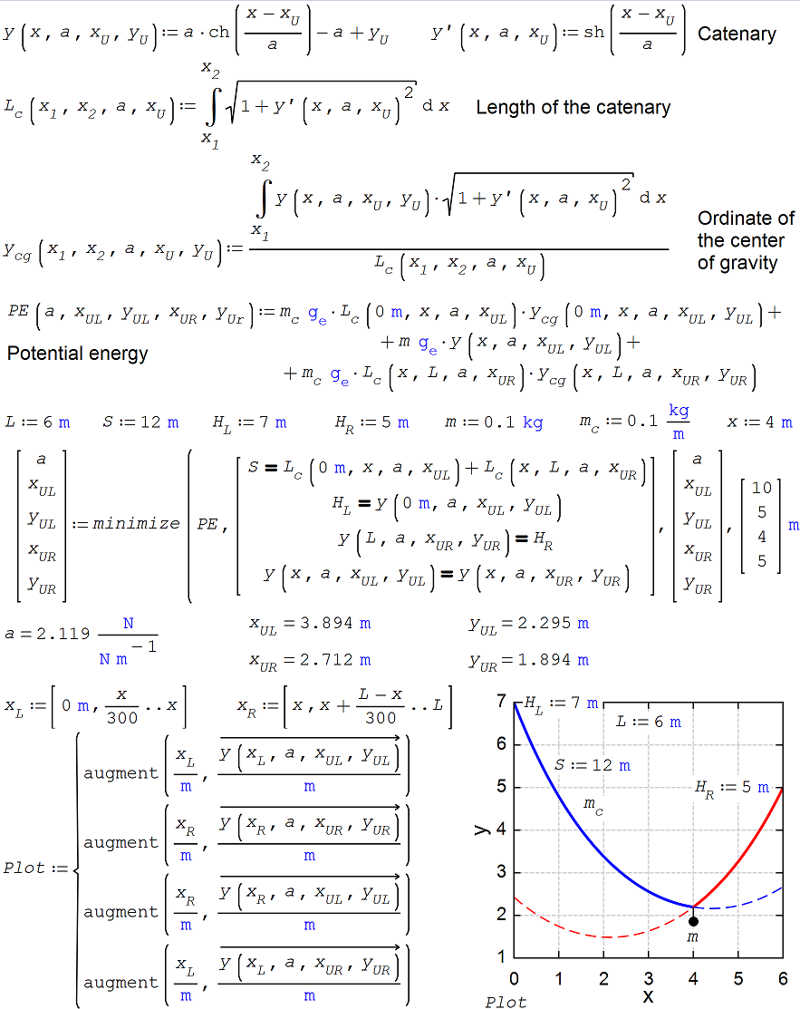

Hi Valery. This file uses Lagrange multipliers method for minimizing.
CatenaryG.sm (45.09 KiB) downloaded 1698 time(s).

This version uses maple for the symbolic evaluation of the integrals, reducing the calculation time a lot.
CatenaryG-maple.sm (46.14 KiB) downloaded 1604 time(s).
CatenaryG-maple.pdf (205.4 KiB) downloaded 1060 time(s).

Hi. I think this may be the solution to the problem with a sliding mass.
CatenaryG-sliding mass-maple.sm (36.77 KiB) downloaded 1675 time(s).

Hi Alvaro,
Once again, thanks for this nice piece of high-flying mathematics, based on Lagrangian optimization, handled by Maple.
Unfortunately, I can’t run your application completely because I received this kind of message:"Lexemple est incorrect"
I’m not sure how to set the optimization option? All on “symbolic”?
If I may a suggestion, it’s to prepare a little bit in advance certain values, as for instance, the length o a cable segment can be obtained without integrating at each use.
I wish you a nice Week-End,
Ioan
