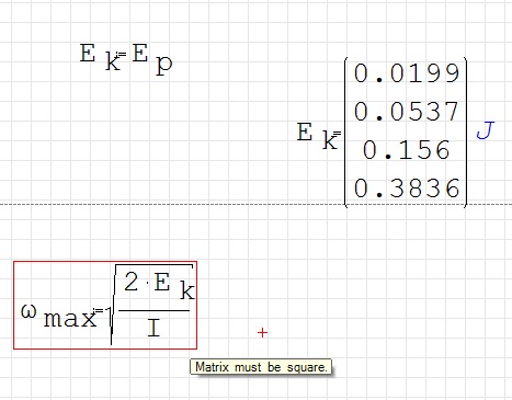

I get the following error: "Matrix must be square" when taking the SQRT of a single column Matrix.
Is there some way to do this calculation?

One of the ways
Ek.sm (4 KiB) downloaded 1373 time(s).
#3 Posted: 2/17/2013 6:40:09 AM
You may consider using lists (AKA "systems" ). If the input values are obtained as matrix, then the function sys2mat from the CustomFunctions
Plugin may help.

Thank you, that works!
