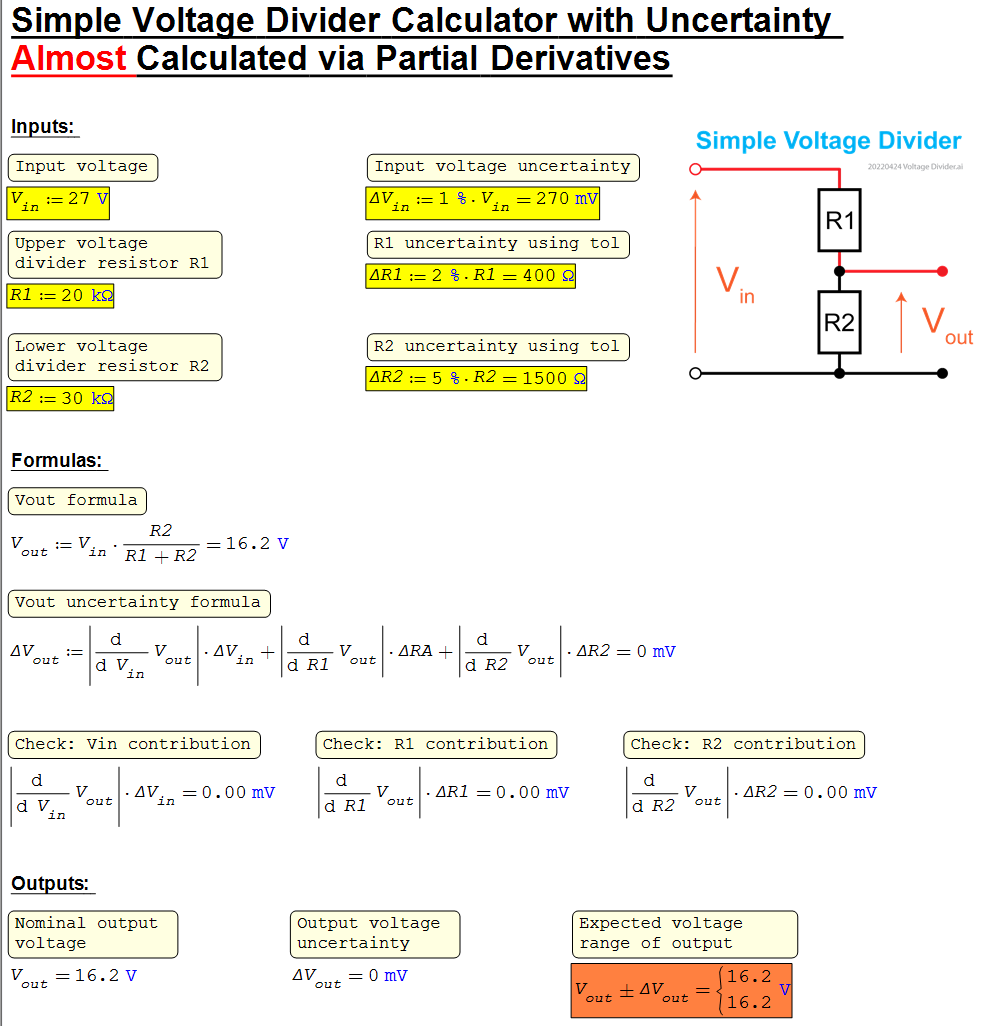

I've been diving into partial derivatives, but I think I am making a basic tool-use error as the calculated derivative contributions are all zero:
20220424 Simple Voltage Divider with Tolerances A3.sm (56.75 KiB) downloaded 1282 time(s).
Thank you in advance.

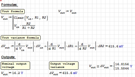

Hi. The quick solution: Put the definition of V.out before the values definitions (and change DRA by DR1).
The technical solution: Use V.out(V.in,R1,R2) instead V.out. The only problem is that this way the expression for calculating the error is very long, visually.
The intermediate solution: unassign the variable "inside" the definition of V.out.
The main reason: like in mathcad, in smath the numerical derivation does not follow the usual rules of evaluation and does what is "Hold" in wolfram mathematica and "uneval" in maple.

Hi. The attached have two functions for automating the process of work with absolute or relative uncertainties from the formula of a magnitude.
Abs and Rel Uncertainty.sm (63.81 KiB) downloaded 1190 time(s).
Abs and Rel Uncertainty.pdf (169.66 KiB) downloaded 764 time(s).

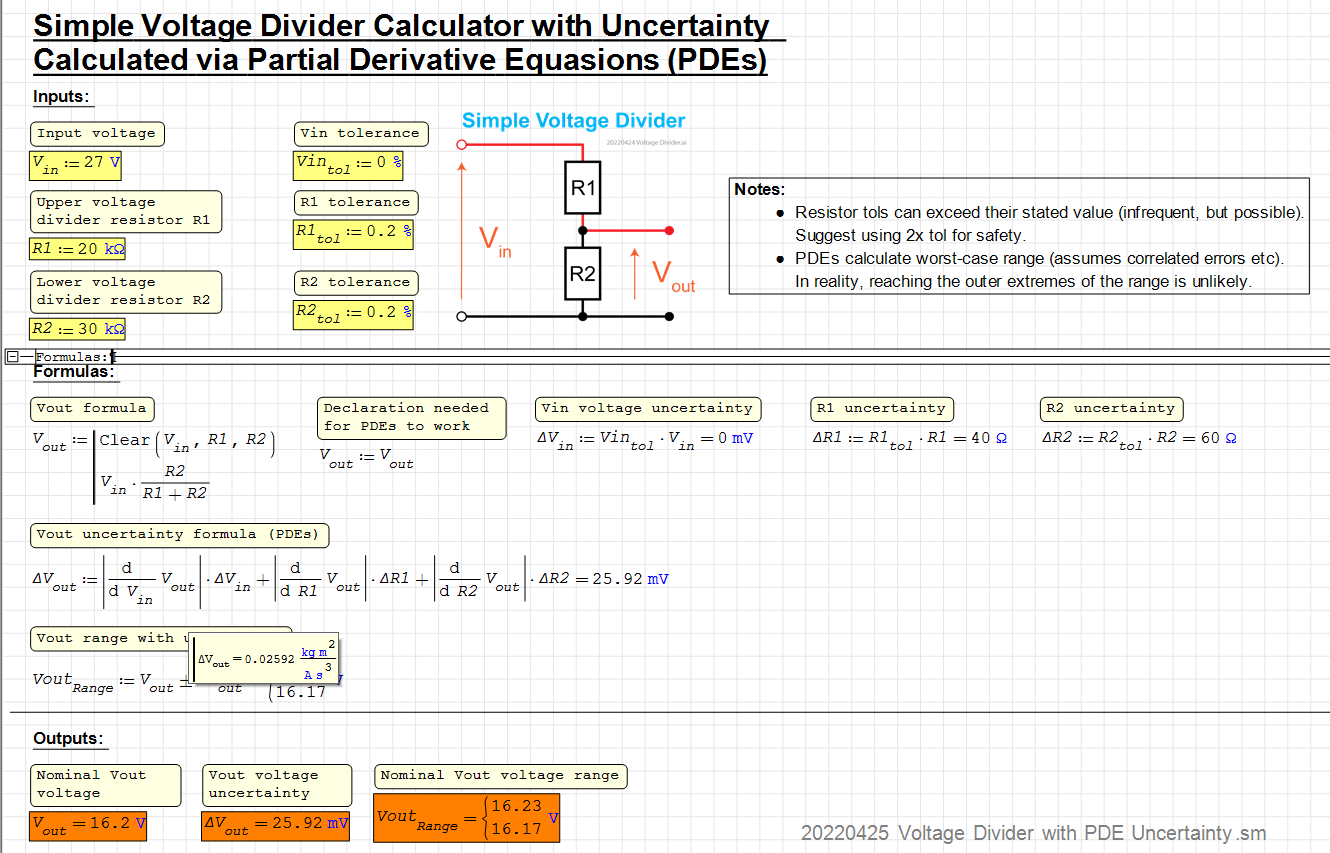

Thank you for your help everybody. Here it is working:
20220425 Voltage Divider with PDE Uncertainty.sm (59.27 KiB) downloaded 1316 time(s).
