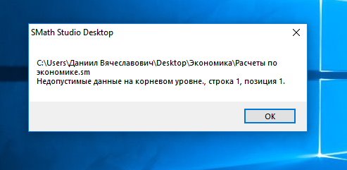

При открытии файла появляется окно ошибки:
"Данные на корневом уровне недействительны. Строка 1, позиция 1."
"Data at the root level is invalid. Line 1, position 1."
Версия: 0.99 (сборка 6839)
Прикрепляю файл:
Raschety po ehkonomike.sm (68.25 KiB) downloaded 1426 time(s).
Пожалуйста, ответьте, я работал с этим файлом очень долго ;(
Если возможно восстановить хотя бы часть данных, буду очень благодарен
Прикрепляю файл:

It's a pretty strange kind of damage, never seen before by me.
The file starts with a sort of *.ini data content, then there is what seems a chunk of a *.pptx archive and finally the worksheet tail. o_o
Unfortunately there seems to be only a small part of your original worksheet still there.
Raschety po ehkonomike_recover.sm (5.42 KiB) downloaded 1386 time(s).

#8 Posted: 4/14/2020 4:59:59 PM
Hello.
This file looks very strange for me too.
But from what I see it seems that file was correctly written to the file system but another software have wrote its data over this file from file start. So for me it looks like it is some error into another application (something about MS PowerPoint) or file system.
