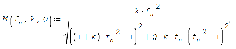

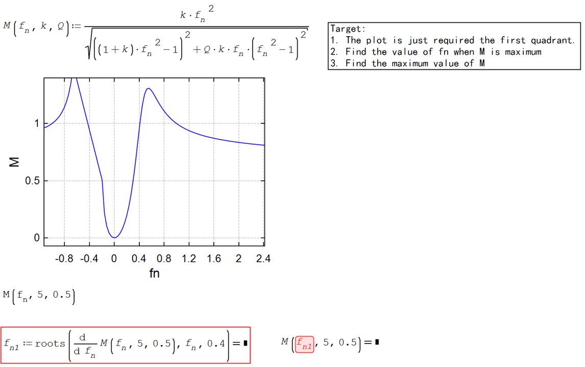

Hi, guys:
Here is a formula
And the Targets are:
1. Draw the plot, but only the first quadrant is required.
2. Find the value of fn when M is maximum.
3. Find the maximum value of M.
I did the 1st target successfully, but can not find the values of fn and M. I have tried my best and search the forum but could not find any way to fix it. Please help to fix it, Thank you very much!

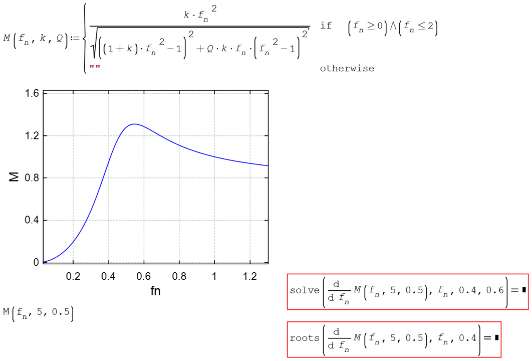

#2 Posted: 2/25/2023 9:57:08 AM
liwenbus
liwenbus
0 likes in 2 posts.
You need the Golden ratio ... doctored version.
If the function is a data set, spline/smooth the region
... as well the FindIndex is a good utility.
LLC Doctored for MAX.sm (27 KiB) downloaded 59 time(s).
Golden ratio QUICK Copy.sm (123 KiB) downloaded 54 time(s).

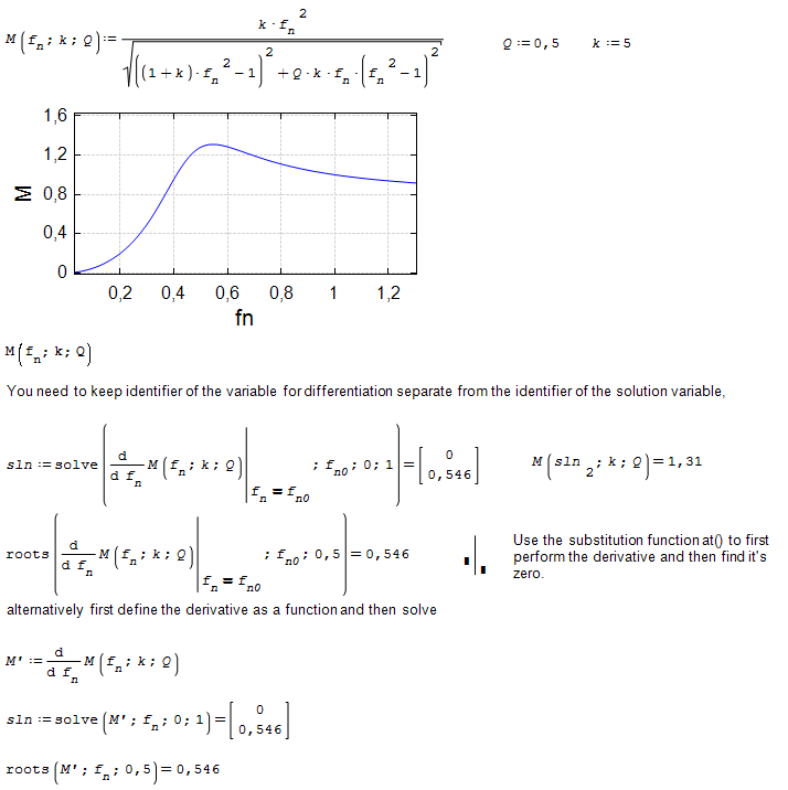

#3 Posted: 2/25/2023 2:41:41 PM
1226 likes in 2153 posts.
The built-in functions are perfectly well suited for the purpose. You just need to separate differentiation from root finding.
LLC.sm (11 KiB) downloaded 65 time(s).

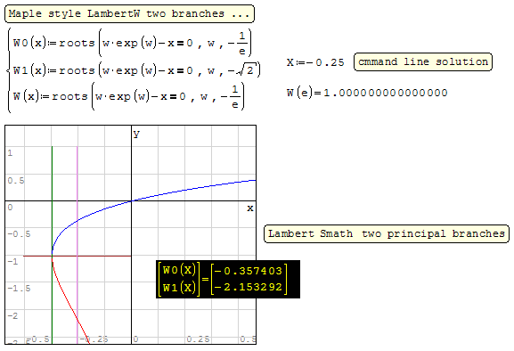

#4 Posted: 2/25/2023 8:54:24 PM
983 likes in 6866 posts.
... refreshed version.
Golden Search Copy.sm (23 KiB) downloaded 51 time(s).

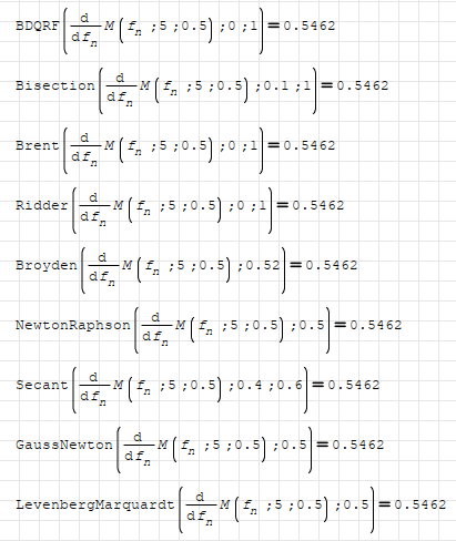

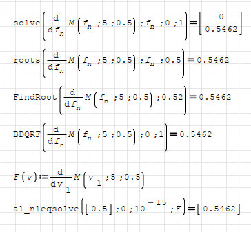

#5 Posted: 2/26/2023 8:58:40 PM
554 likes in 1333 posts.
Here is your functions peak point solved with various solvers.
LLC1.sm (9 KiB) downloaded 62 time(s).
#6 Posted: 2/27/2023 10:55:02 PM
It all depend upon the accuracy you want.
Smath was not even ½ pregnant that roots existed from libraries.
#7 Posted: 2/27/2023 11:13:37 PM
Apart from Findroot() there are other functions in Nonlinear Solvers to.
Check that plugins page in Reference Book, there may some info you can use.
LLC1.sm (13 KiB) downloaded 64 time(s).
