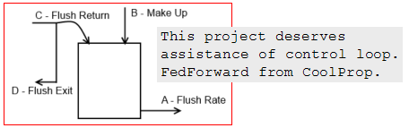

In my plant 20 pumps require flush water which is supplied by a close circuit water flow network. Flush rate & max temperature rise are per vendor specifications. Hot purge & simultaneous volume makeup by fresh water is what maintains the temperature.
I am attaching my solution to the problem. I further need to have multiple plots (on same graph) which corresponds to different temperature rises indicated by equation defining Tc. Please advice

I am waiting for a heat exchanger (with temperature loop) which will take x3 months. In the meantime I want to use make up water for temperature control by hot bleeding. Bleeded stream will not be wasted & goes to Cooling Tower makeup ...
Better wait the heat exchanger c/w control loop.
Detail: most likely the control algorithm will be Lead/Lag.

Revisit the heat exchanger LMTD.
Cheers ... Jean.

Mr. Jean thanks for your input but we will be using Plate & Frame heat exchnagers which design is very differnt from tubular exchangers.
Now I have x2 matrices (ranges) changing TB (5 values) which plot a curve at changing TC (3 values) ...so we have x3 curves. Can you change attached file to my requirement
