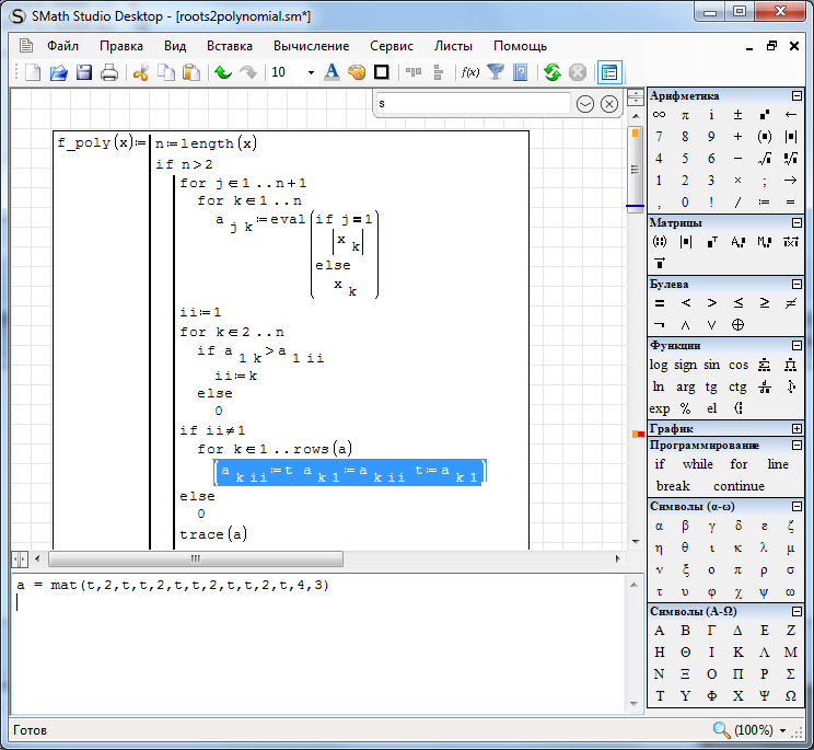

Hi Andrey,
The worksheet in attachment doesn't work in 0.98, but works fine in 0.97.
The error message is "s - not defined". It's bothering me, because of I've used the functions in several documents.
Another issue is that new version 0.98 stays non-responsive for a few minutes when I try to quit SmathStudio.

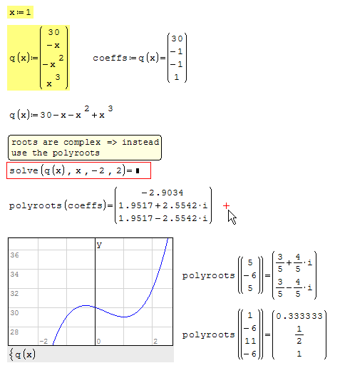

#4 Posted: 3/16/2016 12:55:01 AM
... for the cubic equation, there is in "Samples"
a more robust "Cubic Solver"

You seem to cheat using one-liners that depend on inner order of evaluation. It's not fixed, may change in any new version, so it's unsafe to do that.
Also, you should keep in mind that evaluation defaults to symbolic; so in loops it's often advisable to use eval() to force SMath store direct value to a variable, instead if (sometimes very complex) recursive formula it had stacked up to this point.
roots2polynomial-fixed.sm (16.33 KiB) downloaded 1575 time(s).

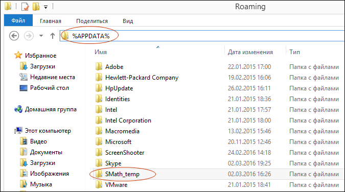

...new version 0.98 stays non-responsive for a few minutes when I try to quit SmathStudio.
I think it is because of some plug-in you have installed on your system. Try to close SMath Studio, then rename SMath folder to SMath_temp in %APPDATA%, then start SMath Studio again and try to close it to see how much time closing will take.

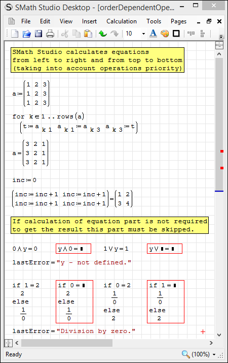

It is because of the following string (in two places):
Starting from SMath Studio 0.98 application handles calculation parts from left to right when no other rules to follow. And it became a rule now which will remain the same in future. So you just need to change places for 1-st and 3-rd operations in your matrix:
Sorry for this, but before 0.98 order of operations in such cases was not actually strictly defined.
Correction: it was unsafe. Now it is absolutely legal way to do such operations. A bit tricky, but legal.
1. Currently, boolean operands are always evaluated regardless if it's already possible to deduce final result. E.g.: (x:=1)V(y:=5) will assign both x and y, despite it's enough to only calc left (or right) part to know the boolean result. Could you please confirm or refute that this will always be so (may I rely on this to create simple (not order-dependent) one-liners?).
Very good question! For some reason (ah, my stupid head) never thought about it. But later better then never... I just did corrections to boolean AND and OR and the final results you can see on the screenshot:
2. Currently, boolean operands are evaluated from left to right. E.g.: (x:=1)V(eval(y:=x)) will make y to be 1, while (eval(y:=x))V(x:=1) will give an "Undefined" error. Could you please confirm or refute that this will always be so (may I rely on this to create complex (order-dependent) one-liners?).
I think, answer is in the screenshot above.
P.S.: I do realize that these changes may result in errors in some existing calculations, but we need to accept these new rules in order to be sure such issues will never appear again in future + rules of a game are now defined.
Best regards!

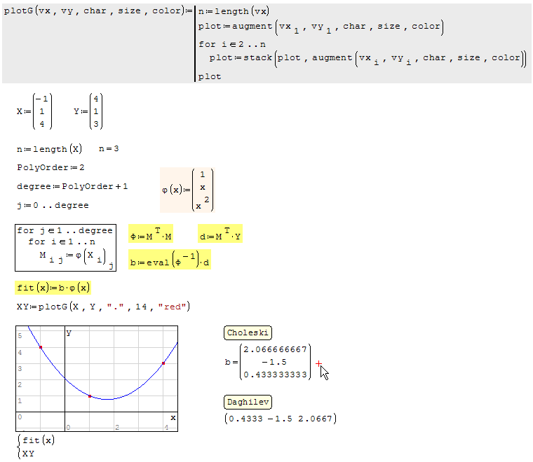

#11 Posted: 3/18/2016 5:09:33 PM
... quick construct
