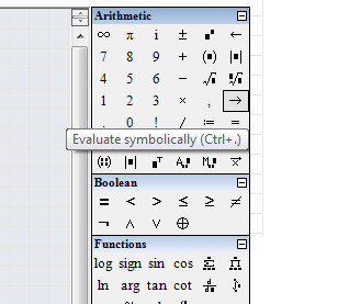

One way to do it, as seen on the images below, is to define f, g, and h first (or define them as functions).
Then evaluate h symbolically. You do this after defining it, using the arrow symbol in the second image. This will show h defined as variables.
Then define the variables, and evaluate for h.

After you define h in terms of g and d is there some trick to show the rest or did you still manually input the function in terms of a, b, c, and d? When I input what you have for h and hit the equal sign again, it says that c is not defined. What I am trying to avoid is having to input the function in this way. If I were to change the function f I would want it to show up in the definition of h and not have to change every instance of it.
#4 Posted: 5/27/2015 10:01:31 AM
snagglepuffin
snagglepuffin
0 likes in 3 posts.
Nevermind, I just figured it out. The arrow is what I need to press instead of the second equal sign. Thank you very much for your help. This helps me out immensely!
