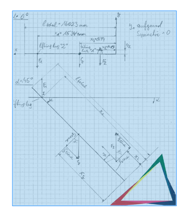

Hey,
while working i considere a problem with a jpg picture.
I can put it in the smath file but i am not able to re delete the picture.
Deleting Picture not possible.sm (544 KiB) downloaded 62 time(s).
Is there somehow a way to delete the picture. The icon is grey so i cannot click it

You have to select the region then you can delete it (left-click on a point outside the region, hold down the mouse button and move over the region; it will become blue-colored).
![2021-09-02 12_12_53-SMath Studio - [Deleting Picture not possible.sm].png](/en-US/file/UMRpor/2021-09-02-12_12_53-SMath-Studio---_Deleting-Picture-not-possible_sm__png)
This is a general rule. Any region when focused (left click on the region) it is supposed on interaction within the content and therefore you cannot delete the container (also depending on the region you might have different options in the context menu when it is focused or selected).

ok thank you i got it :-)
