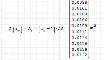

Hi, I got stuck trying to do the following:
The divisor matrix is:
I need the c.mn results
I'll appreciate some help, thank you in advance
Edited 2/11/2026 12:36:16 AM
#2 Posted: 2/11/2026 8:58:30 AM
127 likes in 342 posts.
I imagine you want to achieve element-wise division. You can use the vectorize function.

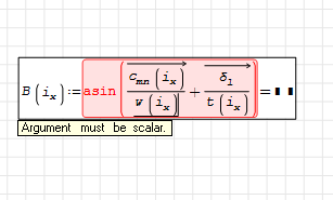

Thank you, it worked. But now im having a different problem, as shown below:
Wondering if it's truly unsolvable in Smath since I cant have scalars there bc I have to vectorize the functions
#4 Posted: 2/11/2026 12:18:58 PM
The external function "asin" should be evaluated element-wise.

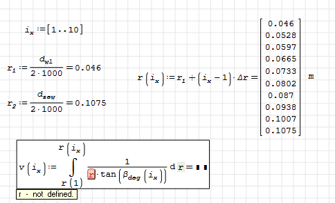

Thank you a lot, it worked. Got stuck again here:
#6 Posted: 2/11/2026 7:15:32 PM
Don't confuse subscripts (obtained, for example, with a.1) with array or matrix indices (obtained, for example, with a[1).
