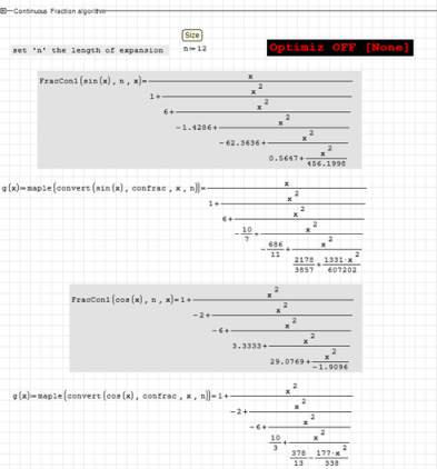

For the ASIN, ACOS and ATAN functions, applying the CONFRAC function of MAPLE
in SmathStudio 7666 gives the result of "Empty stack"

Thiele Unsolved J_Frac Expansion.sm (63.85 KiB) downloaded 1301 time(s).
