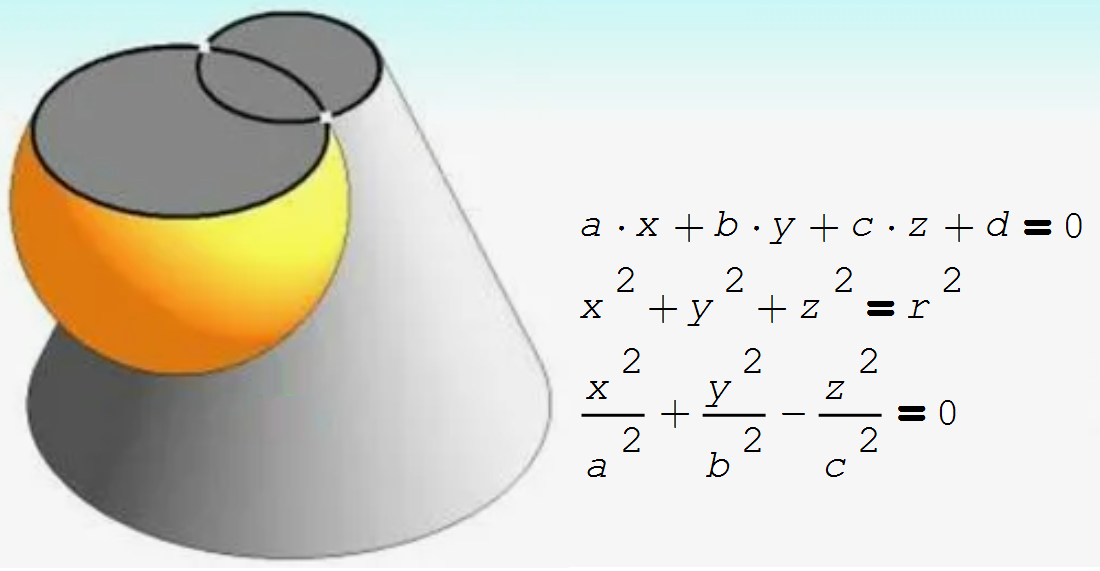

I want to solve three equations with three unknowns and display the solution on a 3D graph with two points - the roots of the equation.
Help please!

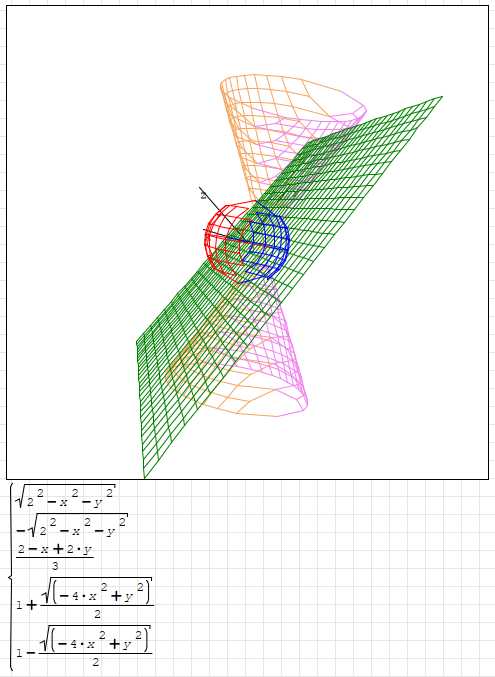

#3 Posted: 2/20/2024 11:02:25 PM
598 likes in 1,380 posts.
Findroot() or roots() could solve three unknown systems.
About plotting, I simply wrote equations according to solving of z.
3Dplot_OchkovVF.sm (4.51 KiB) downloaded 1480 time(s).
Valery Ochkov 2/20/2024 11:05:00 PM, Davide Carpi 2/21/2024 5:30:00 PM

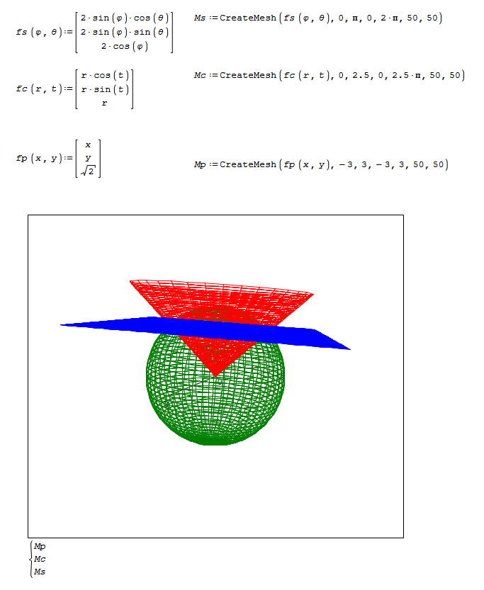

#6 Posted: 2/22/2024 6:38:16 PM
StvMath
StvMath
44 likes and 1 dislikes in 71 posts.
Is there a way to use CreateMesh() for single line xyz equations?
x^2+y^2+z^2-2^2 creates a sphere in 3dplot, a finer mesh can look better.
But I don't know how to convert an equation to CreateMesh().
I am asking if it is doable of course, if they are two different thing it is ok.
A simple, short but inclusive tutorial would be beneficial.
Like in the attached? (Though I confess it was a "suck it and see" approach as I don't fully understand the 3D graphing!)
TriangleSpherePlaneCreateMesh.sm (6.92 KiB) downloaded 1555 time(s).

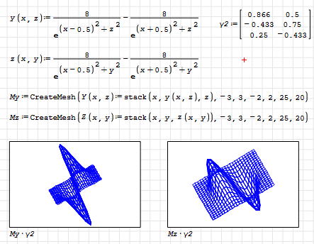

#8 Posted: 2/29/2024 11:56:27 AM
Hi Overlord. If you can isolate some of the x, y or z variables, you can use this. If not, Viacheslav develops a 3D implicit plot codes for mathcad, you can see that somewhere in the mathcad forum.
create_mesh_xy.sm (8.42 KiB) downloaded 1545 time(s).
Вячеслав Мезенцев 2/29/2024 4:48:00 PM

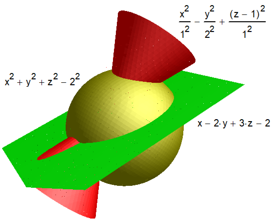

#9 Posted: 2/29/2024 4:46:48 PM
1,555 likes in 1,867 posts.
The dots on the graphs above are a sign of my code being used.
I ask for a method converting a xyz function to CreateMesh() matrix.
This is only possible for simple cases if the function is easily parameterizable.
