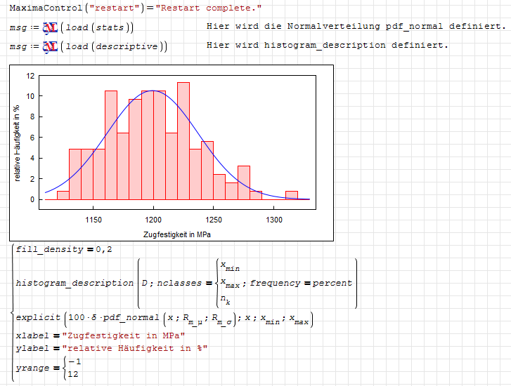

#8 Posted: 1/12/2019 9:33:48 PM
See Maxima docs for available functions and options
![2019-01-13 01_24_47-SMath Studio 0.99.6884 - [Streuung.sm].png](/en-US/files/Download/urKVug/2019-01-13-01_24_47-SMath-Studio-0.99.6884---[Streuung.sm].png)
Streuung.sm (45.46 KiB) downloaded 1209 time(s).
streug.rar (291 B) downloaded 337 time(s).

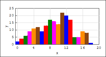

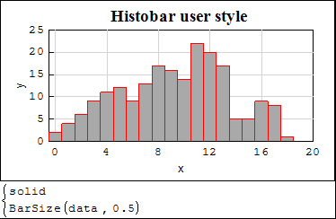

#9 Posted: 1/13/2019 8:48:58 PM
WroteThis demo to illustrate the CLT
From native Smath, you can have:
1. colors at will [rich from X_Y plot], even white to imitate no bar.
2. Slightly separated, joined, slightly overlapped.
3. solid or hatched at will.
Stat Histogram BarColor.sm (26.33 KiB) downloaded 1179 time(s).
