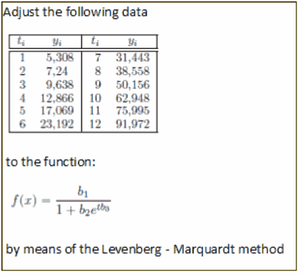

#1 Posted: 7/17/2018 9:17:58 PM
CBG
CBG
78 likes in 312 posts.
Levenberg_Marquardt_Code_CBG.sm (137.38 KiB) downloaded 1265 time(s).
Carlos

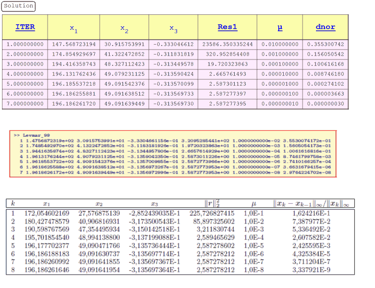

#2 Posted: 7/18/2018 12:03:02 AM
Thanks Carlos,
For meditation. Hover the pointer on φ(x,β) to see Conjugate Gradient.
The model is puzzling, if you want so: can try expGrow as an exercise.
Genfit Minimize MODEL Test.sm (39.95 KiB) downloaded 1196 time(s).
