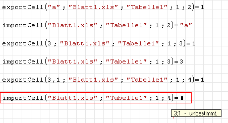

the excel plugin indeed is somewhat broken. You can write data to a file and read in again but excel can't read that file. Also reading in does not work for floating point numbers, just for integers or strings. Keep in mind, that the file must exist before reading or writing to it.
Alternative would be to use wfile with separate vectors for individual columns and replace the argument delimiters (e.g. by newlines. Then gnuplot should cope. Eventuelly, you can define an input format directly in gnuplot. I never did data export. Rather I would then go for Maxima, Octave, Scilab or the like. SMath for me is fine as long I can take advantage of the GUI and the 2D doc format. Of course, all these tools would be able to read wfile format (with some regexp coding) and make nice plots out of these. However, they could generate the data perhaps directly.

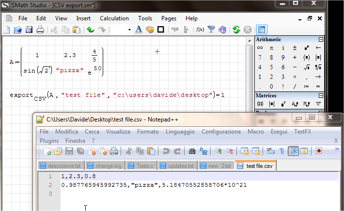

Hi martin,
you can try with the SMath matrix editor. (actually not available beacuse the wiki server is unavailable)
If you are brave enough you can try with the plugin attached here (it's a beta, I'm sure that works for the common cases but I have not had time to check for special cases)
EDIT: here there is the plugin updated and extended

thank you for your help. Export CSV function is that what I need.
Now I can be happy user of Smath
