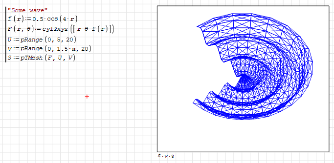

#1 Posted: 10/23/2021 2:42:13 AM
Hi. There are several variants for the triangular meshs. This is one.
pTriMesh.pdf (459.2 KiB) downloaded 826 time(s).
pTriMesh.sm (29.35 KiB) downloaded 1469 time(s).

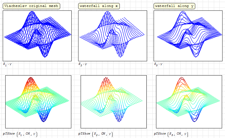

#4 Posted: 11/18/2021 2:12:26 AM
Hi. More general mesh utility, with a variable patern. Also, waterfall plots (matlab page here).
pWMesh.sm (193.8 KiB) downloaded 1449 time(s).
pWMesh.pdf (3.2 MiB) downloaded 889 time(s).
