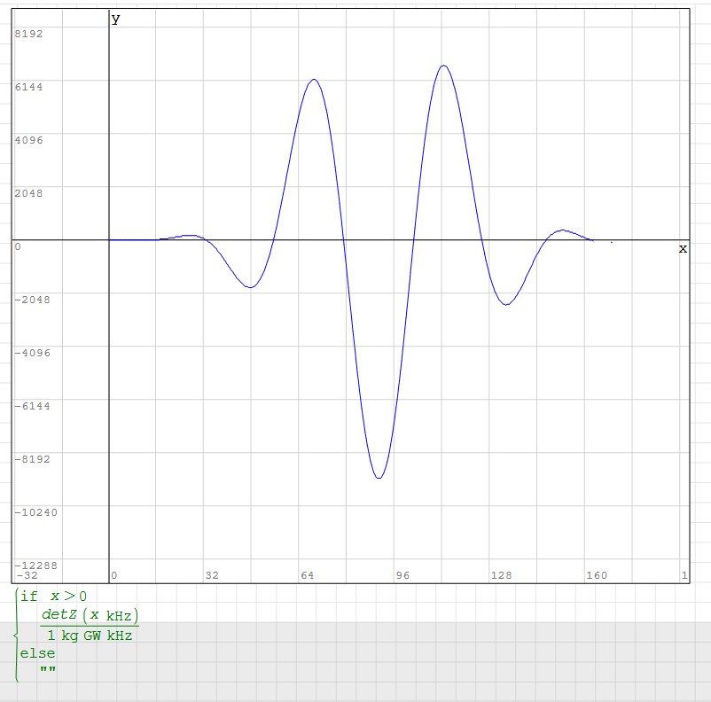

I'm trying to reproduce the attached plot (coming from MathCAD) in SMath
and I'm not able to obtain a plot of the function nor even dividing the function by
1E+10 - I suspect a pb dealing big numbers - by the way I have also an error trying to use MAXIMA GNU.
Has anyone some idea/workaround?
Many Thanks

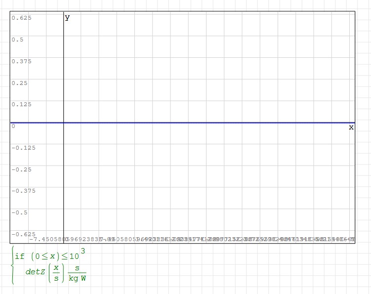

Here attached the file so that you can see "hands-on" the issue.
For TMMT.sm (99.5 KiB) downloaded 1657 time(s).
I still suspect a limitation in plot function dealing with "big" numbers....but even dividing by 1E+08 (and even more...)
seems to work in this case (I made some other tests and, sometimes, this trick is useful).
As you understand I need a "visualization" of the function in order to "guide" the "solve" function (that seems
to work remarkably well w.r.t. MathCAD, by the way....but I cannot always be so lucky in this kind of problems...).

2) As you can see I can easily calculate the values of detZ(x) and find roots....BUT no plotting at all. By the way, due to complexity
of the function detZ(x), this last cannot be written explicitely....

Units are good, always try to use them.
But plotting doesn't like units.
Get rid of them if you are plotting.

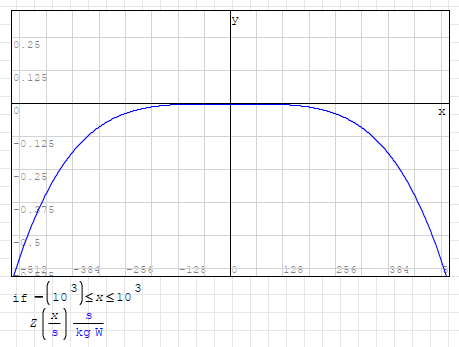

Thanks Overlord! First I tried to reproduce the image in your post: just ADDING the unit of measures (as I have always done in MathCAD...but evidently I have not learnt the lesson.....) something is plotted....so, additional question how do you add the line with conditional statement (if...) that, if I understand well define the window range (also very very interesting for my pb)?

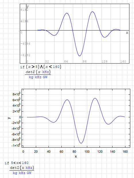

Hi. You can scale the plot choosing adequate units on it. With the exception of al_nleqsolve, there are not pure numerical solvers in SMath, but you can write your own one. It seems also that the limit for numerical evaluation of your function is about s = 160 kHz. Finally, it's true: native SMath plot can't handle very well long ranges, but XYPlot plugin can.

many thanks once more, as I have both solved the problem and, most of all (for a beginner like me), learnt something more...
In any case, it seems to me that each SMath installation has its own combination of "tricks" working (or not working...).
For Overlord, don't bother with my further question on range definition, I have found in the meanwhile....but still not working (see below)
But once I combine the use of Plot native SMath function with unit scaling and range definition (as suggested and worked out by Razonar) and range definition...it works both with SMath native plot and with XY plot!!

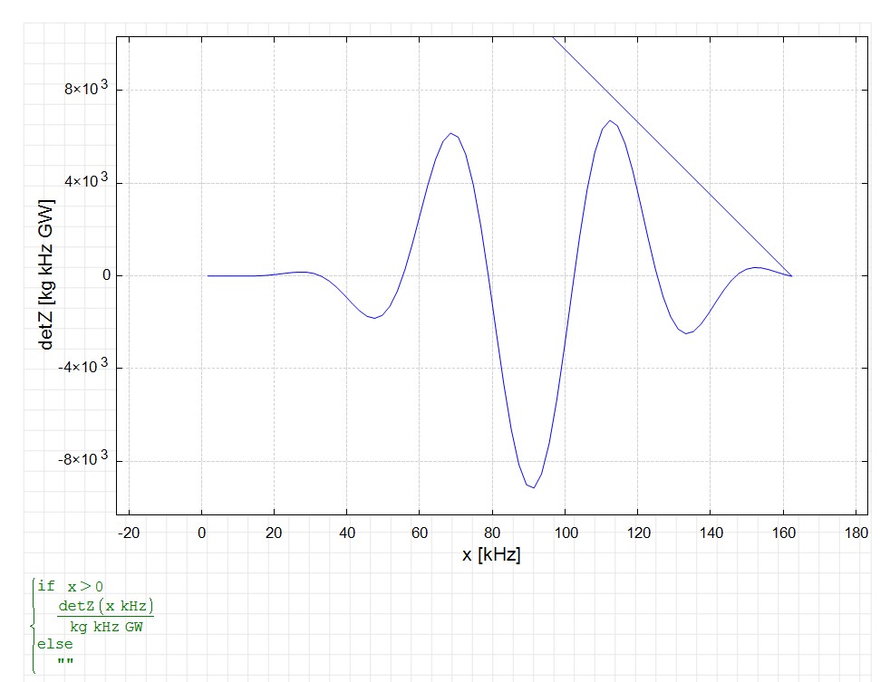

More, I tried to plot (with XY plot) the function for values higher than 160kHz; and, yes, something strange is happening for (see below); the same seems not using SMath Plot functionality
In my specific case, at least, frequencies over 160 kHz are not so critical (the lowest ones are the most worrisome). So, for the moment as said, my problem is solved....next step is to further complexify the function detZ (Omega)...
I asked that phenomenon to uni (author of XY Plot plugin).
It is caused by an algorithm to speed up plotting process.
If it really bothers you (it bothers me), there is a trick.
You can eliminate it by setting different start and end parameters.
Oscar Campo 8/3/2023 3:01:00 PM

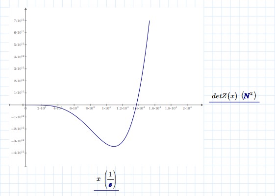

Your 2nd plot looks a distorted Morlet.
In the attached you will have to reconstruct both graphs.
set sigma:= sqrt(16) ... span 'x' 2nd plot for convenience.
Plot X_Y ± 16 perfect.
Cheers ... Jean.

For Overlord: what you propose, works but....have a look here below.....File not found.File not found.
The function seems to me too complex to make a study of the function (I mean limits, derives, max, min); but I'd like
to perform such a study 'cause I expect an "asymptotic" behavior for values higher than 162kHz (last zero)...maybe it's
this asymptotic behavior at the basis of the "strange" plot.
For Jean: interesting, I discovered something!! And even strange because.....my function comes from vibration of short hollow beams.
Best Regards and thanks again
