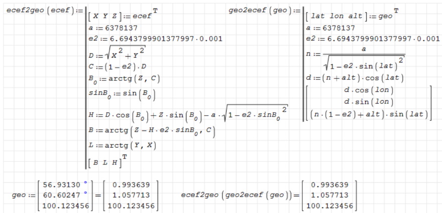

For heights from 0 to 15 km.
ecef2geo (Ogorodova).sm (9 KiB) downloaded 81 time(s).
1. Ogorodova, A simple method of transforming geodetic rectangular coordinates to geodetic curvilinear coordinates is recommended. (pdf, rus).
ecef2geo (Ogorodova).pdf (335 KiB) downloaded 99 time(s).
2. Converting between Earth-Centered, Earth Fixed and Geodetic Coordinates
