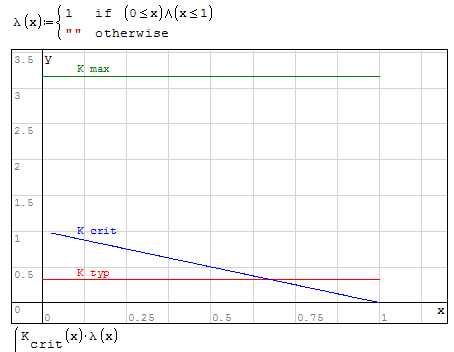

Bolean bug(s) are user bug.
Many projects will accommodate either style if/else ... if/otherwise
A long suite of conditions is horror if/else.
Doctor your plot 1 as proposed, press F9

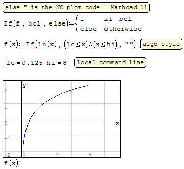

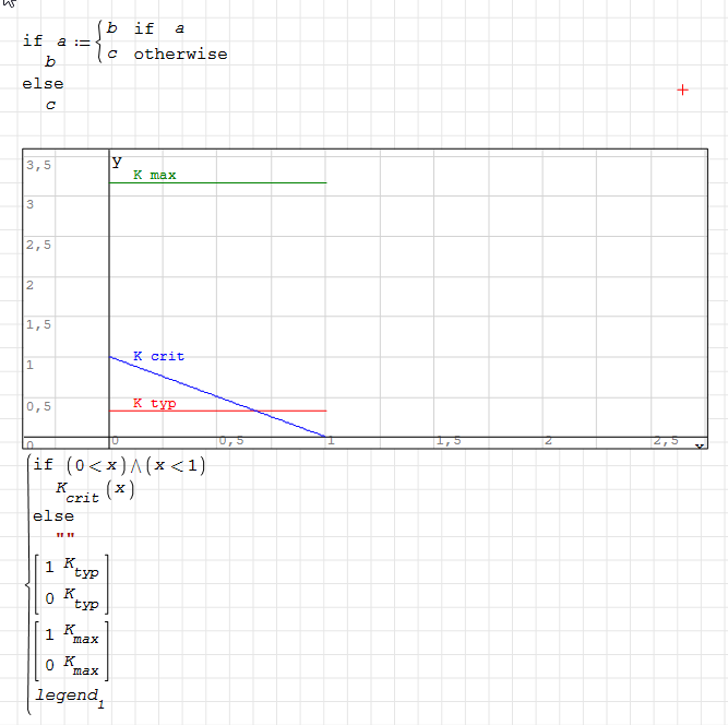

... doctored for convenience.
Observe collected plot, easy to manage.
Cheers ... Jean.
