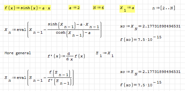

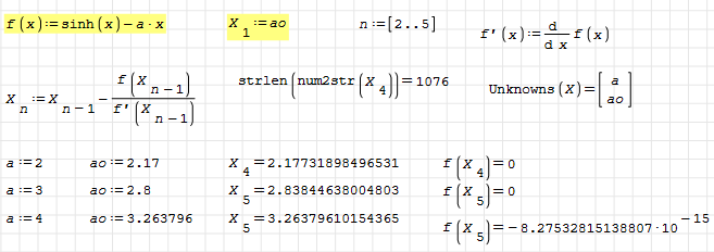

Hi ioan. If we understand 'analytical expression' as 'closed form', the answer is that there is none. But if the objective is to find the real solution, with as many digits as the precision of the calculator used, then it is enough to remember that real numbers are introduced to be able to calculate limits, so this would be a valid answer.
nr-example.sm (9.37 KiB) downloaded 1370 time(s).

1. In fact, I’ve already used the Newton solution. I like your elegant iteration control. I used a trivial "for" or "while" command. However, the result’s precision is essentially dependent on the machine’s precision (bytes number on a variable).
2. My problem is an engineering one: the analysis of the catenary structural cables. High numerical precision is not an objective for me.
3. I looked for an explicit mathematical solution, in order to avoid iterations. Really, it’s more a caprice than a necessity. Basically, I hoped to have a simple formula for the intersection of a hyperbolic sinus with an inclined line, but I see that mathematics ways are as well simple as complicated…
4. In the SMath environment there also is a compact, numerical solution based on the "solve" command (see the annexed file).

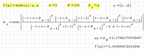

#4 Posted: 9/30/2023 3:00:52 PM
Hi ioan.
Here the root is expressed as the limit of a recurrent sequence as well, but in terms of basic operations.
nr-example 2.sm (14.52 KiB) downloaded 1377 time(s).
2. My problem is an engineering one: the analysis of the catenary structural cables. High numerical precision is not an objective for me. [/i]

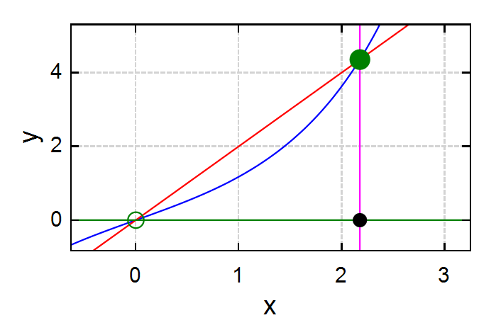

#5 Posted: 9/30/2023 6:10:37 PM
Hi Alvaro,
Thank you very much for your additional solution.
This last solution seems resulting with a more modest convergence.
The graphical image of the case is:
It seems that the 4th degree polynom decomposition of the equation, solved without any iteration is enough reasonable; of course, less compact than the solution based on the solve function
Best regards,
Ioan
Best regards,
Ioan

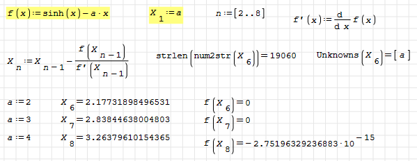

#6 Posted: 10/1/2023 3:08:46 PM
Wrote... This last solution seems resulting with a more modest convergence ...
Yes, it is. But it uses only algebraic operations! This other provide a better approximation using actually only one expression, even it is very long (19060 for the string length)
nr-example 3.sm (9.03 KiB) downloaded 1357 time(s).

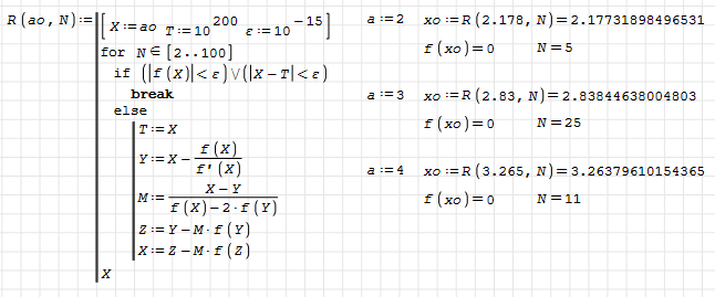

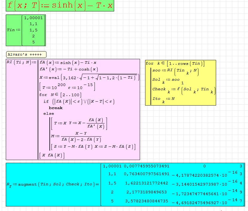

Hi ioan. Dichotomy is always better because it provides an interval of the solution. Here, some other notes:
You're right: the start value is part of the solution, and it requires better attention. This version uses different guess values.
This other is an Improved Ostrowskiroot-finding method, by Miquel Grau & Jose Luis Diaz-Barrero
nr-example 3.sm (19.28 KiB) downloaded 1353 time(s).

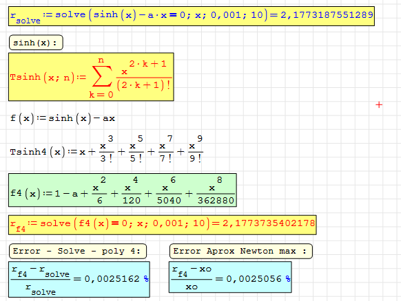

#10 Posted: 10/2/2023 12:47:12 PM
Hi Alvaro,
Thank you for your last improvements.
I see that my mathematics end only as a modest engineering tool, while yours seams going much further.
In the appended file, I synthesized my available answers.
Ioan Synthesis 20231002.sm (66.68 KiB) downloaded 1380 time(s).
Please take a look and make any improvements that you feel as appropriate.
I’m sorry, I hadn’t included too much commentary, hoping that things are comprehensible enough as they are in the context of the whole thread.
I noted a large range of results. However, for my purposes,Ioan Synthesis 20231002.sm (66.68 KiB) downloaded 1380 time(s). the available results satisfy my expectations. Now I reached “my incompetence level” (according to Peter’s principle) …
I still have another equation bothering my tranquility, but this maybe for another occasion.
With all my gratitude please receive
My Greetings from Paris,
Ioan
Finally, I mixed my raw first approximation with your last findings and here it is:
![2023-10-02[SelectPlus.sm_].png](/en-US/files/Download/B4r2dP/2023-10-02[SelectPlus.sm_].png)
