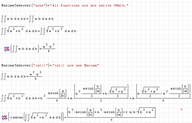

#9 Posted: 10/2/2014 6:37:24 PM
1226 likes in 2153 posts.
This is what Maxima does.
Edit: the second integral can be simplified using one of the many Maxima simplification functions.
Davide Carpi 10/2/2014 8:01:00 PM, frapuano 4/9/2018 7:26:00 AM
