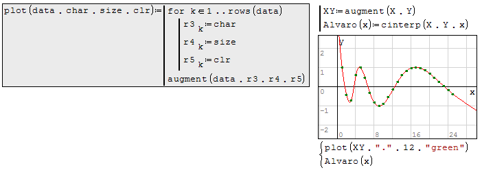

Two red remain ... but here the XY plot.
Cheers, Jean
cspline test.sm (42.54 KiB) downloaded 1338 time(s).

#5 Posted: 8/29/2018 12:35:12 AM
Hi Jean. Thanks, but you know me ... I want to use my own function.
I messed your coding to make readable.
As it looks, you seem to implement Hermite cubic or an unknown brew ?

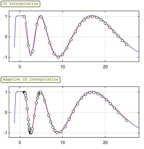

Hi Jean. There are not to much shadow in that small code. It's just the implementation of the traditional spline interpolation. In SMath there are not, or I can't found, the function cspline. The interpolation with cinterp in SMath evaluates the vector V each time that you call it, it's always better to have V=cspline(X,Y) and then call interp(V,X,Y,x). Finally, I want to implement an adaptive step size for the intervals in X. But first I see very convenient to have vectorization and plotting issues solved.

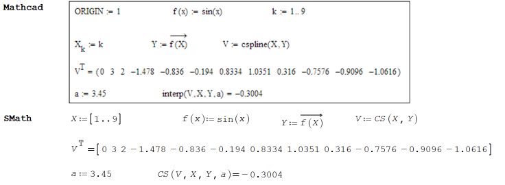

CS only do what mathcad's cspline do:

CS only does what Mathcad's cspline does:

CSplines with adaptive steps. Same issues, but now can use zero with units, at least in the adaptive case.
adapt cspline test.sm (83.25 KiB) downloaded 1275 time(s).

Numerical derivation from the Smath d/dx is not possible ... WHY ?
The derivative operator derives wrt to rules that apply to function(s)
cinterp(X,Y,x) is not a function, only an interpolating function.
Alternately two ways:
1. from the dspline(s,X,Y,t) ... 's' from solving
2. from the infinitesimal D1(x,h,f) ... where 'f' is cinterp(X,Y,x)
Exemplified in the attached ... Jean
